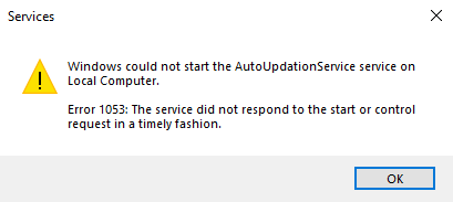

Saqib
India
KERNELBASE crash in Windows 10 64bit command line
Hi Martin,
I am also facing same issue in Windows 10
Faulting application name: AutoUpdationService.exe, version: 1.0.0.0, time stamp: 0x5ab1103d
Faulting module name: KERNELBASE.dll, version: 10.0.16299.309, time stamp: 0xd3aa915c
Exception code: 0xe0434352
Fault offset: 0x001008f2
Faulting process id: 0x305c
Faulting application start time: 0x01d3c3704d0529b8
Faulting application path: I:\AutoUpdationService\AutoUpdationService\bin\Release\AutoUpdationService.exe
Faulting module path: C:\Windows\System32\KERNELBASE.dll
Report Id: b838ba69-a045-415e-ab75-c347694c65e6
Faulting package full name:
Faulting package-relative application ID:
43,068
Re: KERNELBASE crash in Windows 10 64bit command line
Saqib wrote:
Hi Martin,
Sorry, I do not see any relation to WinSCP here.
Saqib
The issue is because of this Kernel issue the service to initiate the WinSCP is not starting at all. If we force to restart the service, we are getting these errors.
Do you still think there is no connection between the starting of service to start WinsCP.
There's no connection apparent from your report. Do you have any reason to believe there is a connection?
