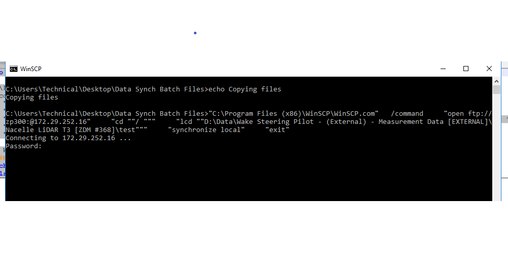

I'm using the following code:
echo Copying files
  /command ^
    "open ftp://zp300:@172.29.252.16" ^
    "cd ""/ """ ^
    "lcd ""D:\Data\Wake Steering Pilot - (External) - Measurement Data [EXTERNAL]\Nacelle LiDAR T3 [ZDM #368]\test""" ^
    "synchronize local" ^
    "exit"
if %WINSCP_RESULT% equ 0 (
  echo Success
) else (
  echo Error
exit /b %WINSCP_RESULT%
And am presented with the attached screenshot where I then need to hit space and then enter before it will proceed to successfully synch.
Any support would be greatly appreciated!
Thanks again!
mmartin82
Re:Any Progress
Hi Martin,
Adding dummy into the password filed worked.
Thanks for your help resolving this.
Much appreciated!
