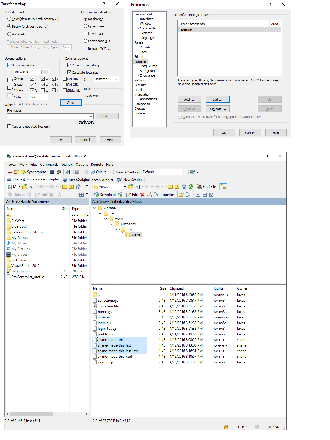

Can someone explain to me as a newby how to utilize this upload options feature, to set all uploaded files to 644 and all uploaded directories to 755?
It looks like it's set default to rw-r--r-- (+x) and then inside has the option to add X to directories.
Is this good to go as is? It just needs to be ticked at Set Permissions? Or do I have to change or add anything out front?

You can configure the default permissions of uploaded files in Preferences:Yes but what about for creating a new file? There is no way to set the permissions when you create a new file. It gets created with 644 permissions and then you have to change the permissions to what you want.
https://winscp.net/eng/docs/ui_pref_transfer

Can't get the Set Permissions checkbox to apply to newly created files. My process is right-click -> new file, ALL of my modes in the Transfer settings are Set Permissions (checked) to 755.
New files do not come in with these changes.
Can't decide if it doesn't work or if I'm not doing it "right".
Step by step what-to-click-when-making-new-file instructions would be appreciated, 'cause I'm unable to get WinSCP settings to function.
