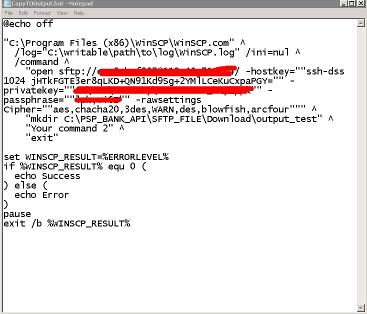

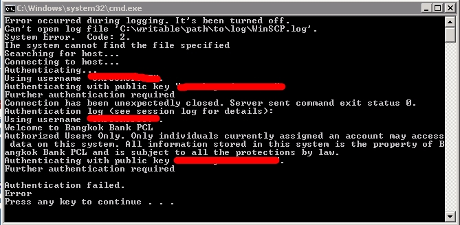

yimiez
Batfile error in Authenticating with pre-entered password
I have a problem with file .bat
Can't Authentication with pre-enter password
Anyone can help ?
Anyone can help ?
Site Admin -
Re: Batfile error in Authenticating with pre-entered password
@yimiez: So what kind of "further authentication" does your server require? Can you authenticate in WinSCP GUI? Or using any other client? Can you post session log file from WinSCP scripting and a successful authentication using WinSCP GUI (or the other client)?
