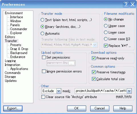

I usually use this exclude mask.
.project;.buildpath;.cache;.settings;.cvsignore;CVS;.svn;
I tried these also.
.project;.buildpath;.cache/;.settings/;.cvsignore;CVS/;.svn/;
.project;.buildpath;*/.cache;*/.settings;.cvsignore;*/CVS;*/.svn;
.project;.buildpath;*/.cache/;*/.settings/;.cvsignore;*/CVS/;*/.svn/;
I've tried to reproduce the problem with the exactly same paths and the the first exclude mask and it works.

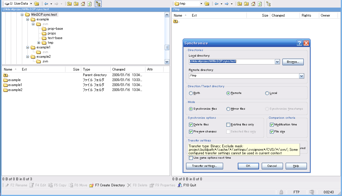

Can you post a screenshot showing the panels and synchronize dialog with all the options?
kanonji
Sorry about late response.
I've uploaded some screenshots.
I'm wondering that these are enough to tell the problem.
As it is shown on PNG file, I tried to upload 3 type of directories(example, example1, example2) after that.
However I could upload nothing.
I cannot try that atm. However I would guess that the trouble is caused by trailing semicolon of the exclude mask. It effectively adds one move empty mask which excludes everything. Can you try to remove the trailing semicolon?

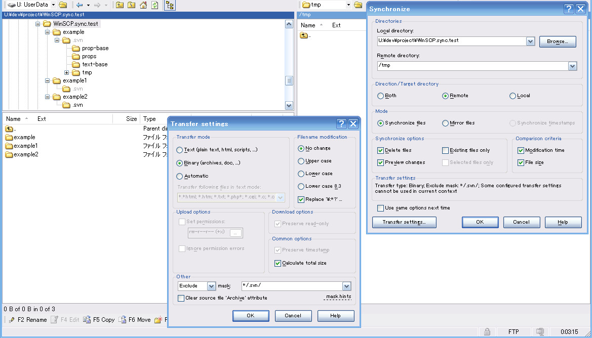

kanonji
Even I can not understand what "trailing" means, I try without any semicolon.
Attached is the screenshot.
I've uploaded none of 3 example directories yet with exclude mask */.svn/.
