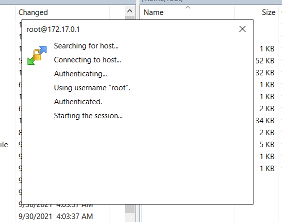

Stuck at "Starting the session". Please help
yellow1912
I can use PuTTY just fine, but when I try to use WinSCP to connect to my server, the program stops at "Starting the session" and just hangs there forever. I tried to login other servers just fine.
Any suggestion is really appreciated since I'm a Linux newbie.

Re: What was the solution???
In WinSCP change the Shell in Advanced options to shell (type in). This fixed my issue connecting to Citrix NetScaler.
AdrianW
Re: WINSCP hangs while starting a session
The cause of the problem might that the remote directory does not exist anymore AND you have set
Advanced -> Environment -> SCP/Shell -> Shell: "Default"
The failure to set the current directory seems to break the shell auto-detection. So if you set an explicit shell, the problem goes away.
Other solutions:
  • choose an existing directory (Advanced -> Environment -> Directories -> Remote Directory:)
  • re-create the directory in a separate SSH session.
@AdrianW: THANK YOU.
This is exactly what the issue was in my situation. Changing the SCP/Shell from "Default" stopped my WinSCP from hanging when logging in.
However, changing it to any of the other 3 available options (/bin/bash or /bin/ksh or sudo su -) causes my WinSCP to report Authentication Failure when attempting to log in.
Of course, my authentication details are correct – I have verified them and can log in via PuTTY using those credentials with no problems.
Can I please ask, what other options I can use to specify a different Shell? Or "set an explicit shell" as recommended by @AdrianW above. I have no idea what to select or what to put here.

sloncer
Issue Resolved
My WinSCP session was stuck at "starting a session". The issue I had was in the .bashrc file I had a command to sudo to another user. Once I removed this line, WinSCP worked. So please make sure .bashrc doesn't have sudo or cd to a directory that has no permission for the user.
sridevi
Facing starting the session stuck issue with WinSCP terminal
When trying to open WinSCP terminal the terminal is stuck at starting the session line and not proceeding further. Please help to resolve this error
TheG
NetScaler specific setting
Was having this problem too with ADC/NetScaler – even though has worked in the past fine on countless upgrades and worked on another NetScaler fine on the same day.
Took a while to figure out – but I had to go into the "Raw Site Settings" in the Advanced drop down while configuring the initial connection. Then Add button -> select Shell from the list, type shell – as the Shell to use (since this is the first command to enter in NetScaler when ssh to the appliance).
Hope this helps someone.
riahc3
First, your Netscaler needs to be configured with a proper password. If it is a new Netscaler, MAKE SURE YOU CHANGED THE PASSWORD INITIALLY. If you connected to the console and it asks you for a NEW password, it will NOT work. MAKE SURE YOU CHANGE THE PASSWORD ONCE. Very important to do this...
After that:
  • Click on Advanced
  • Go to Environment, go to SFTP
  • Where it says SFTP server put
    /usr/libexec/sftp-server
Thats it. You dont need to do anything else in 2026. Period.
@riahc3: Thanks for sharing this. Though it looks like a workaround for a broken server. The path should be configured on the server-side, not on the client-side.
