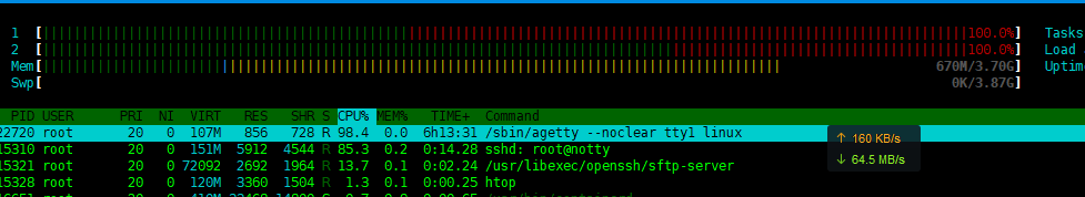

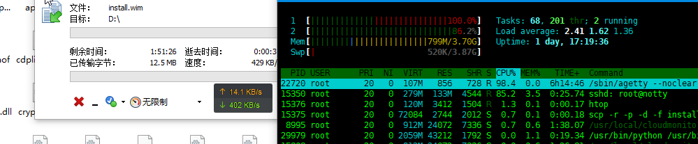

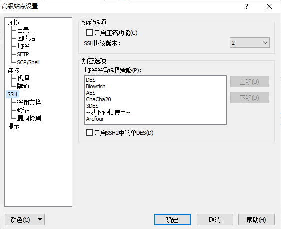

Re: pscp is very faster
anjia wrote:
winscp version:5.15.1 Portable
OS version: win10 1809
linux server version: centos 7.6 mini
winscp options:
close compression
algorithms is DES
WinSCP speed is 400KB/s~500KB/s
Pscp speed is 60/s-70MB/s
What version of pscp? Are you really using ancient DES (not 3DES) with WinSCP? What do you mean by "close compression"? Can you start a new topic for your question? (as this one is quite long already)
