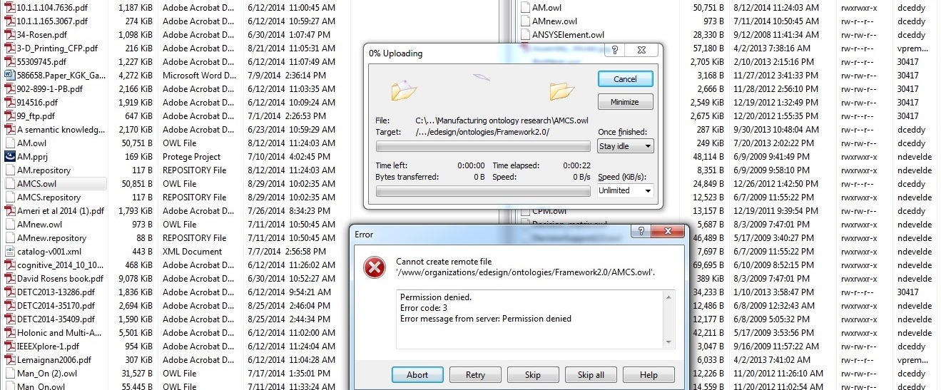

dceddy
Re: Permission denied - Error code 3
I'm having a similar problem to the prior report as shown on this attachment with no Request Code shown on the error message. I try to upload one file with no problem, but have this problem only on a new file as shown. both of these files are the same for permissions settings. I tried several times in case of any file corruption, but had the same issue every time.
Does anybody have any suggestions that we should try when this problem occurs?
@dceddy: So do both files exist in the remote directory, with the same permissions? Or does the first file exist only and the second one (the one your get the error with) is new?
Both files do exist in the same root directory with the same permissions. One is old and one is new. But, I try to upload both to the same directory. The old one does upload to the server and overwrites the old existing file on the server, and the new one will not and has the error message. It is possible that the administrator of the webserver has recently changed something, and I will follow up on that, but I would like to have some idea of what could cause that.
We're having a similar problem. We can rename, delete and create. But when we overwrite, it seems to upload OK but we get error 3 saying upload
was successful, but error occurred while setting the permissions and/or timestamp
The suggestion is to "turn off setting permissions or preserving timestamp" or we can "ignore permission errors".
Not sure what the best option is and the impact of each.
Permissions are fine, and the problem still occurs if we CHMOD 777. We can overwrite file just fine using the same user in FlashFXP.
audit.log and secure log are all green, no problems.
Running WinSCP Version 5.5.4. (Build 4433)
Server : Centos release 6.5 (Final)
@Guest: Please attach a full log file showing the problem (using the latest version of WinSCP).
