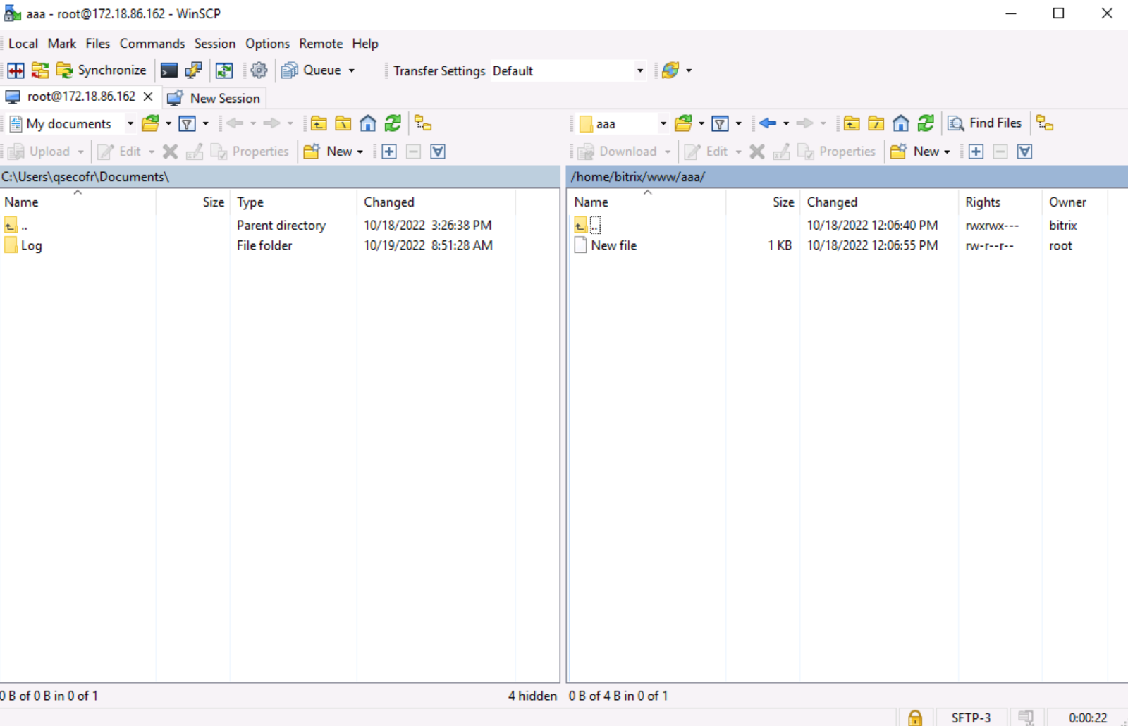

I am trying to copy files from Linux to Windows Server with a script, but I am getting the below error. The file exists but WinSCP can not find the file. I am using a task scheduler for this action. Sorry I didn't find how can open a new topic.

Description: The file is exist.

@balacam: You seem to have the arguments reversed. It should be put source dest (and backslashes in the Windows path):
put D:\Data\FILE\01_MaslakHQ\03_UluslararasiOperasyon\02_BilgiTeknolojileri\00_Public_IT\Code\ /home/bitrix/www/aaa
Additionally you might have the trailing slashes wrong. Ending source path with slash and destination path without is usually wrong.
Please read https://winscp.net/eng/docs/scriptcommand_put
