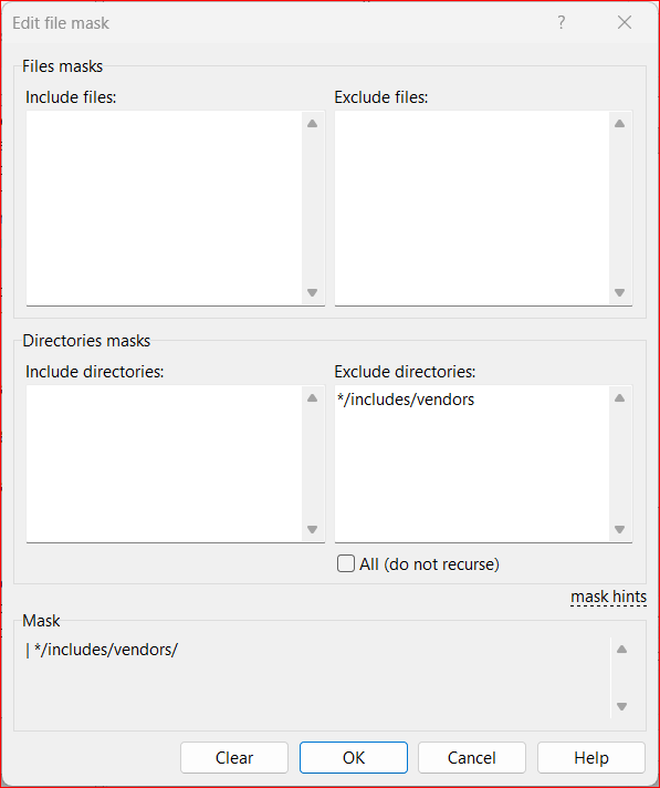

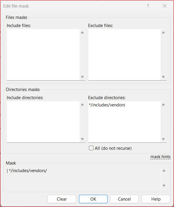

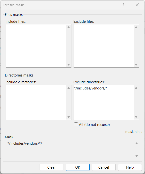

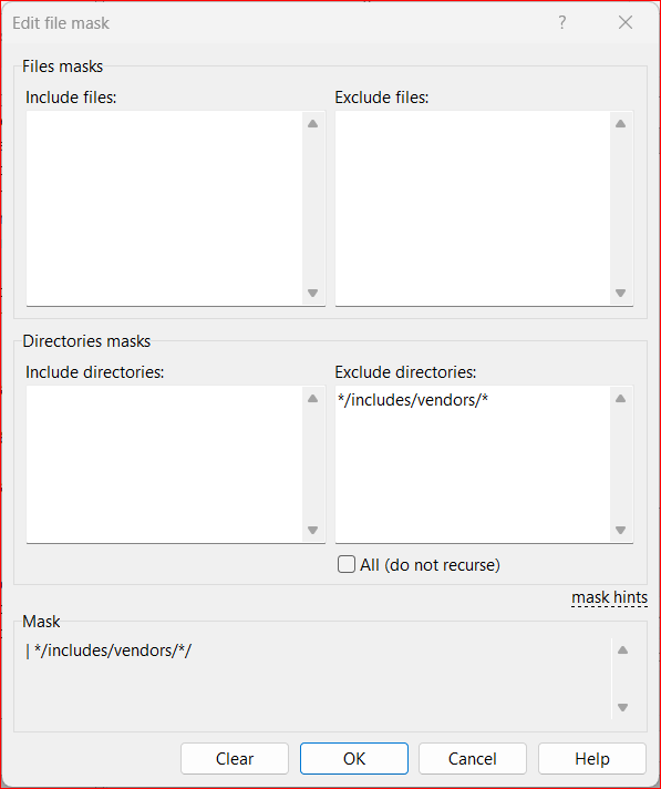

I was already in the right spot, I just had to mess with it a little bit more.
I was already in the right place, just didn't realize that the program *must* have wildcards even for directories. Usually when you include a path, it will include the sub folders. I didn't figure WinSCP would need to go back to the 1900's for exclusions - lol
Now that I fixed it (working vs not_working attachments), it is working correctly.
Thank you for verifying I was in the correct area!
Description: In this setup, it is EXCLUDING the folders and no longer trying to sync them.
Description: In this setup, it was still trying to sync the folder/s.
Re: Exclude files/folders from synchronization
The | */includes/vendors/ mask should be enough (I've just tested it). If it does not work for you, please post a session log file.
That also seems to work, sir. I removed changed
*/includes/vendors/*
to
*/includes/vendors/
and the program automatically stripped the trailing
so it is listed as
*/includes/vendors
I have verified that it doesn't touch any of the 173 folders under it during the scan.
