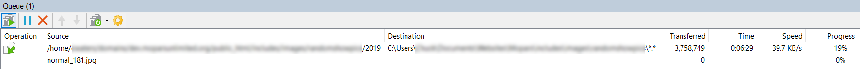

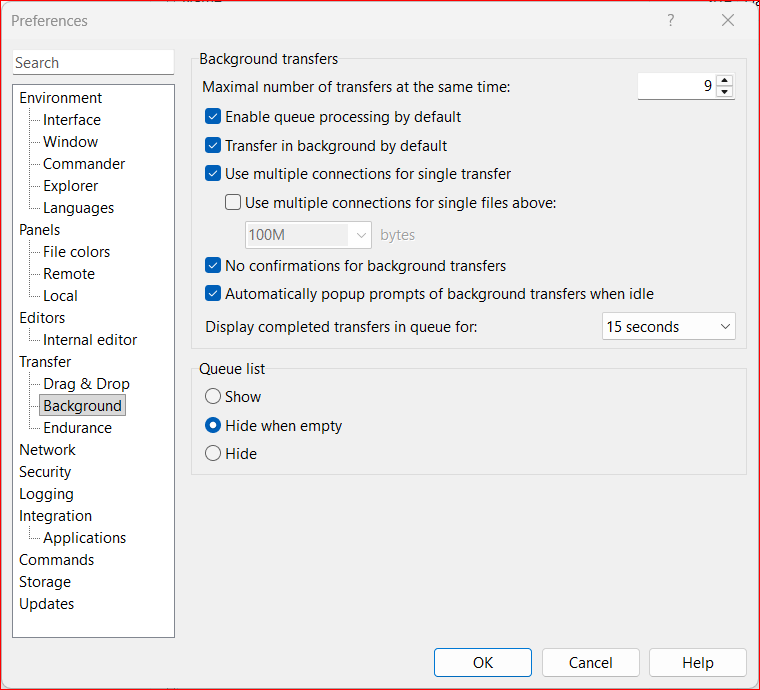

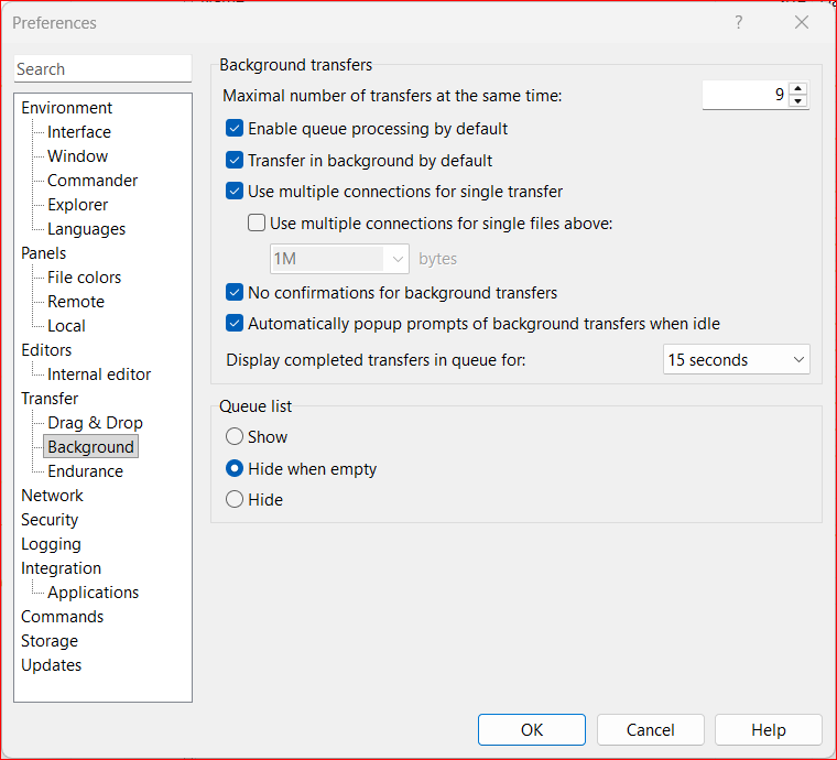

No matter what I do, I cannot get simultaneous transfers to work. They used to work for background transfers and synchronizations.
Just up and no more for some reason.
Description: Showing the configuration selections for background transfers.

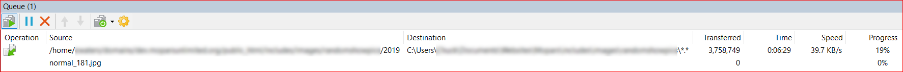

Description: Snippet showing the Background Transfer Connections. There are approximately 50 files in this folder.
43,049
Re: No longer allowing simultaneous connections
Your screenshot shown just one entry in the queue.
So I assume your question is about the "Use multiple connections for single transfer" (rather than "transfers at the same time"). Is that correct?
The "Use multiple connections for single transfer" functionality has some constraints. See the footnote at:
https://winscp.net/eng/docs/ui_pref_background#multiple_connections
That directory that it was transferring from had over 500 jpg's in it. I was displaying that as an example where that used to do 9 connections at a a time for a directory like that, but now, just does the one.

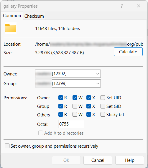

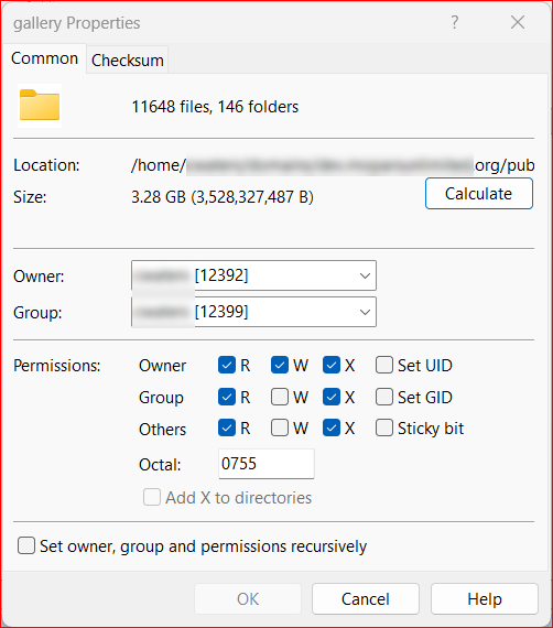

Ok, that didn't do anything. Still Xfering one file at a time. The folder I selected is over 3GB in size (see attached s/s), and over 11,000 individual files.
For now, when I have to transfer a lot of files, I just use FileZilla then go back to WinSCP. However, it would be nice to just use the one and done. :-)
Thanks for the assistance!
Description: Showing the size of the directory currently trying.

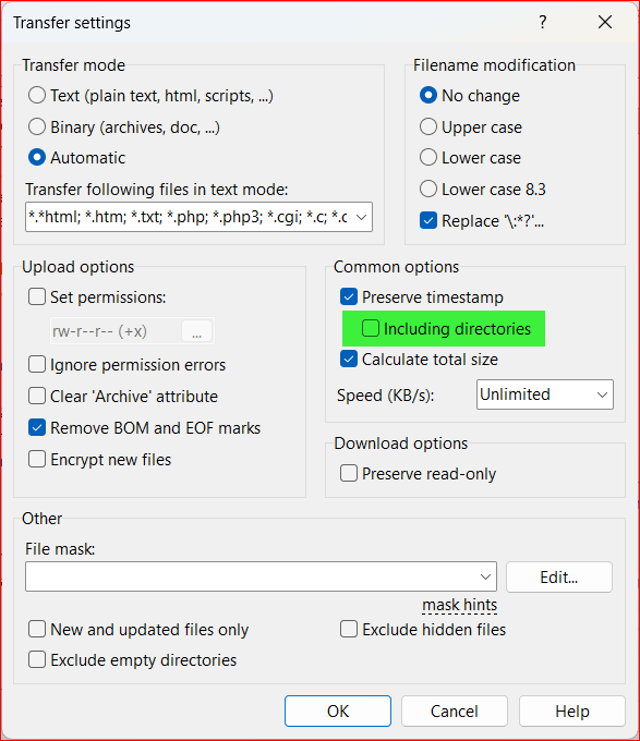

ChuckT
10
Overgaard, AZ
In your case, the constraint that steps in is:
Multiple connections are not used, ... when preserving timestamps of directories is enabled.
Damn it.. I use that for the Synchronize function that I run numerous times a day.
The timestamps is a lot more ... accurate than the size comparison...
It might be misunderstanding. This is about directory timestaps only. The directory timestamps are never used for synchronization.
ChuckT
10
Overgaard, AZ

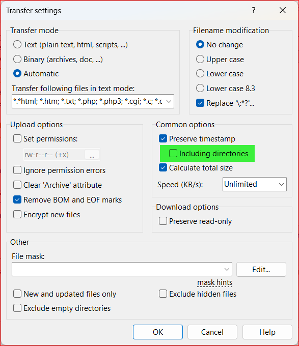

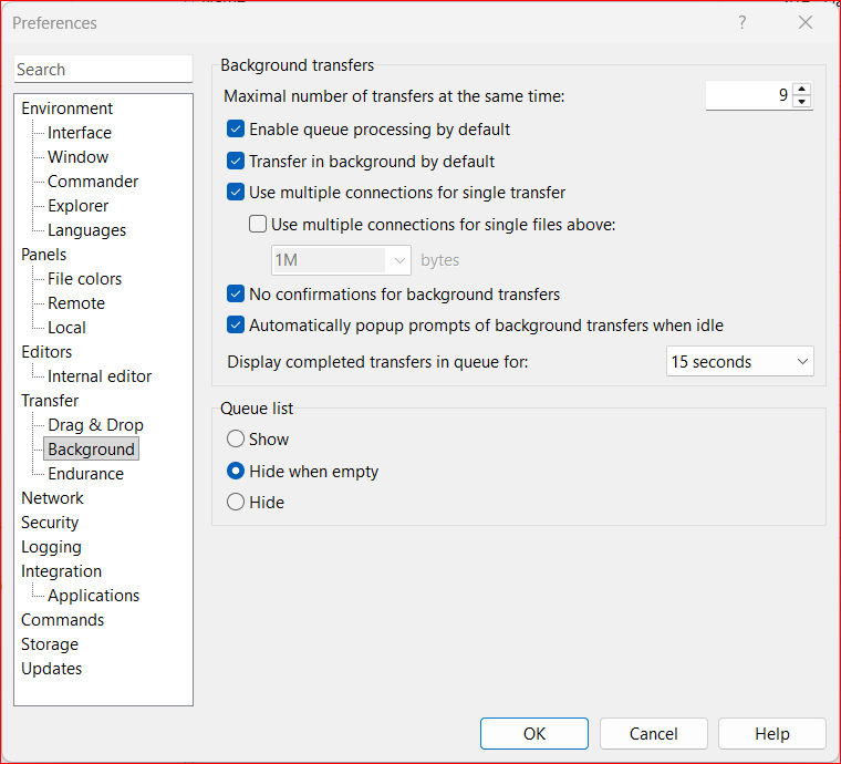

Thank you for throwing the glass wine bottle at my head so hard it broke. That's what was needed! I don't know what it was, but the way you just stated that...
I unchecked the Directory option and did a test for the Sync, and it showed the three files that were changed overnight, and sync'd no problem. Then I grabbed a folder with over 700 files in it and what do you know – 9 simultaneous connections.
I don't remember going back in and checking that, so I do apologize! Thanks for the assistance.
PS: Using Beta v6.6.1

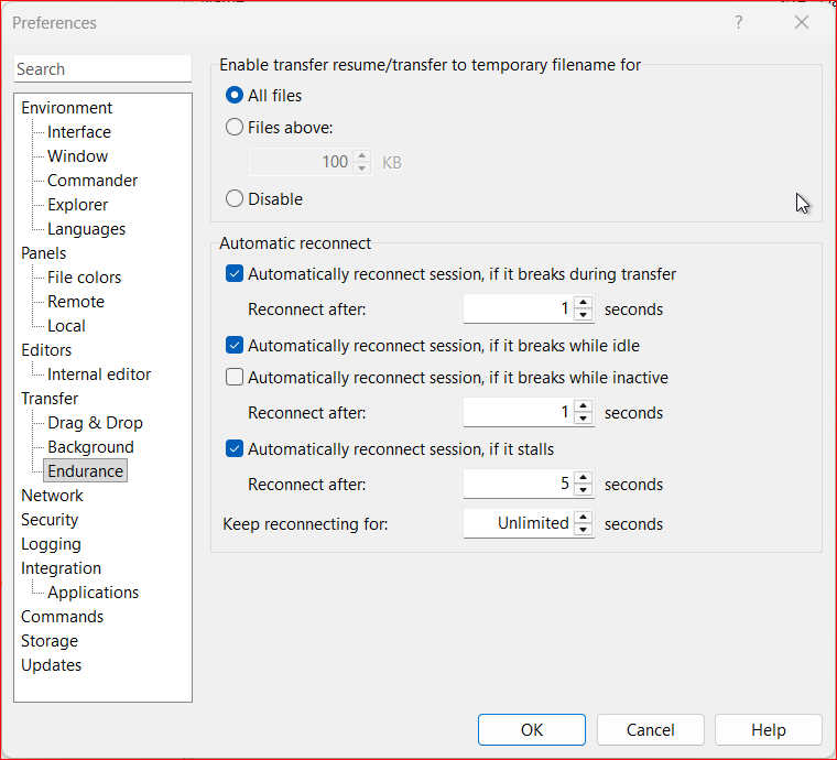

Description: Endurance Settings
Description: Transfer Settings
Description: Background transfer settings.
