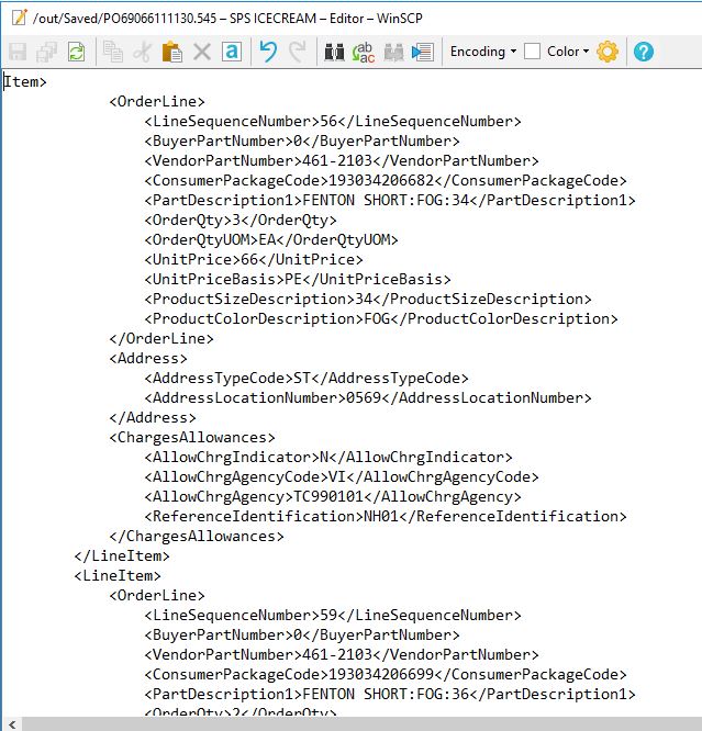

We have a very strange problem. I can open WinSCP (V 6.5.5) in Commander mode and go to a standard FTP (port 21). There are about 40 XML files in the folder. When I double-click on a file to view it, the file has about a 90% chance of showing complete. About 10% of the time, part of the file at the beginning is missing, and sometimes part of the file at the end is missing. If I click on another file and come back to the offending file, it will often open in its entirety. If I download a file to my hard drive, it also has about a 90% chance of being complete. This behavior is shown throughout the FTP site. I have tried clearing caches, uninstalling and reinstalling WinSCP, and nothing has fixed this. I should also say that our ERP is erroring out when trying to read the files, so it is experiencing the same issue. The vendor who is providing the FTP and is placing the files on the FTP swears they do not see the problem at their end. Any ideas would be greatly appreciated!!

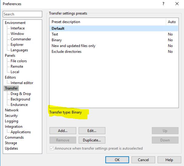

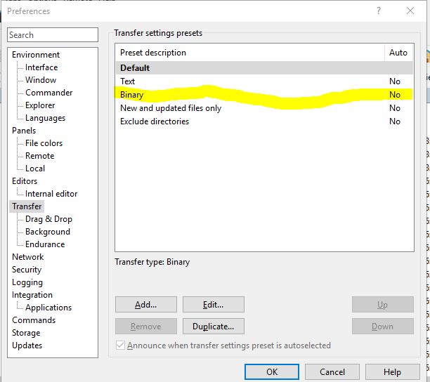

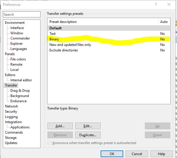

Thanks, @Martin. Before I do that, this only effects the reading of the file, correct? It has no impact on the actual transmissions? I also checked for the setting and it says the default is binary, please see attached. Do I need to somehow get Binary to say yes on the other attachment? If so, how do I do that?

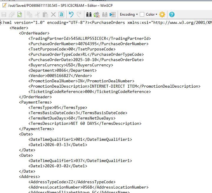

I have attached logs and downloaded files for the same file that downloaded complete and incomplete. It looks like it still says they are the same size, but the files are different. I had to upload across two messages since max attachments is 3. This first one is for the complete file download and log. Thanks for all your help!

I have attached logs and downloaded files for the same file that downloaded complete and incomplete. It looks like it still says they are the same size, but the files are different. I had to upload across two messages since max attachments is 3. This second reply is for the file download and log that is missing the beginning. Thanks for all your help!
Site Admin -
Re: Not sure if FTP server or not
Thanks for the logs. So it's not that part of the file at the beginning is missing, but rather that parts of the file are randomly shuffled.
Again, I believe it's a server-side bug.
