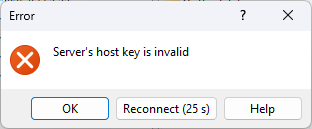

How do I fix this error: "Server's host key is invalid".
I am using WinSCP 6.5.5 on a Windows 11 PC, connecting to a CoreFTP Server on a Windows 7 PC. I can connect to the same server using a CoreFTP client, but not WinSCP. I can connect to a different server on a Windows 11 PC using WinSCP.
I was expecting to be shown a warning message saying the server's host key is not cached, showing me the server's key fingerprint, and asking if I trusted it and wanted to continue, but all I get is "Server's host key is invalid".

I've added the log as requested.
Also I've added a screenshot of 2 logs on a different client, to the same host, highlighting the differences between the logs in red - showing a potential issue with key types. There might be an issue with the key type used? Although why I don't understand, as on the left I connect successfully via www. full name, but on the right I try and fail to connect via IP address.
I'm a newbie to this SFTP! Many thanks for your help.
I think the problem is: How do I define the hostkey, since it doesn't ask me?
