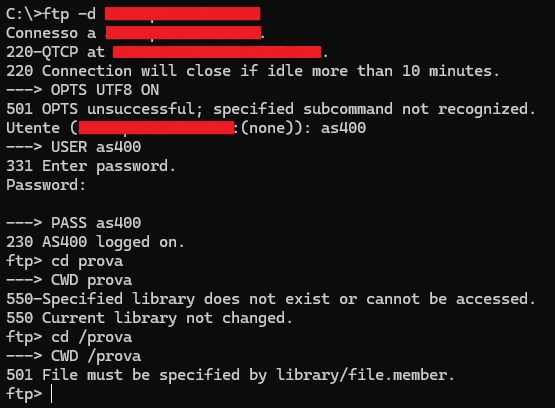

It seems that to get to the /prova path, WinSCP would have to do CWD /prova, not CWD prova. What's the logic on AS400 to tell, when the leading slash is needed and when not?
That's stil ftp client cd command. But ok, the ftp client maps cd command directly to FTP CWD protocol command (try running ftp with -d switch). So what's the logic on AS400 to tell, when the leading slash is needed and when not with cd/CWD?

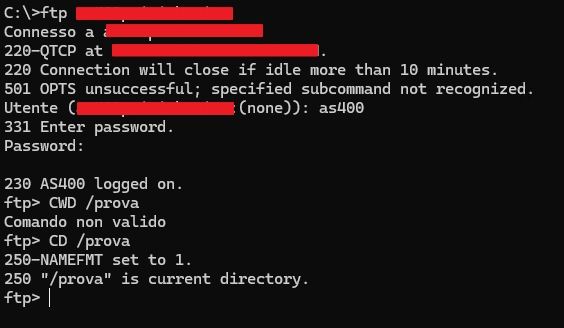

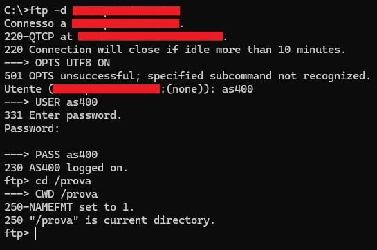

Hi Martin,
if I try the command "cd /prova" it goes to the correct folder.
But if I run "cd prova" (without the slash), I get an error. If I subsequently run "cd /prova" (which previously worked), I get a second error.
From now on any "cd" you play will not work.
