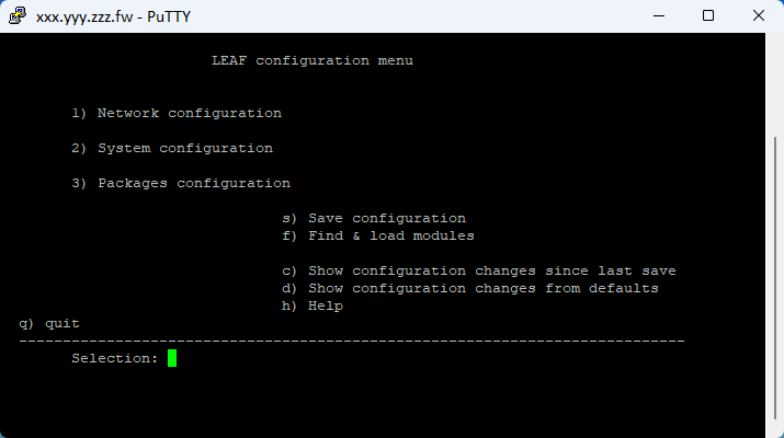

Big thanks Martin. It helped me. Leaf Bering uClibc automatically launches the application after startup, waiting for you to select one of its menu items. PuTTY shows that menu on screen and you can choose one of the points or exit it (choosing q - quit). WinSCP waits for this application to finish. This can be seen in the log. After a while, WinSCP, unable to wait, displays an error message.

When the firewall starts a communication session, it first asks for a login and password.
Then it launches an application that allows you to change the configuration. You must select something or cancel (q - exit) the changes.
This is the standard solution for this firewall. The same is true when starting a session from a Windows computer using PuTTY.
A login, password, and application waiting for selection. The screenshot taken by this application is in the attached PuTTY.png.
