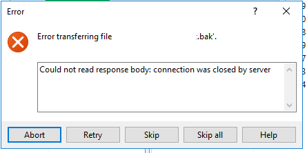

Hi All,
Software does not automatically retry either to upload/download file on failure, but there is a button on the pup up window which resume the process. My file is quite (1TB) and every time it requires a human's reaction which drastically extend the whole process.
WINSCP ver 6.5.3 16364
Preferences/Endurance set as follows:
Files Above 100kB checked
When breaks during transfer reconnect after 5sec, checked
When breaks whilst IDLE reconnect after 9sec, checked
If it stalls reconnect after 60sec, checked
Keep reconnecting unlimited
When using the background process it behaves in the same way.
Regards
R.K.
