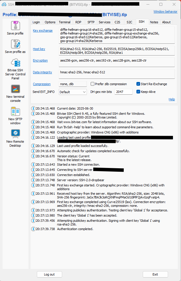

  • Bitvise SSH Client in Windows 11 and device --> SUCCEEDS (see attached files!)
Looking at the log file from Plink, there appear to be mutually supported curves, but it still does not work, no matter what I do or try. With BITVISE it does succeed.

Description: BITVISE CONFIG AND LOG WITH SUCCESSFUL AUTHENTICATION
Description: contains the supported CURVES by the remote device
