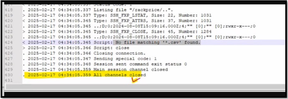

Hi Martin,
I've attached a screenshot of the last log we have from WinSCP at 4:34AM MT on February 17th. It was a normal "All channels closed" message. The next time our internal job ran and called WinSCP there is no WinSCP log and there is no Windows level log showing anything related to WinSCP (error code or otherwise). Our internal job did not have any enhanced logging either so it responded as if WinSCP ran but found no files to move (we know that is not true because there was a pileup of files found 4 days later and they had not been moved).
As for adding the command and getting you logs we are not sure how that will help as the issue is not currently occurring and we are not able to reproduce the issue.
I'm guessing you have never seen this type of behavior from WinSCP.
Description: Screenshot of the last WINSCP log before it would not run.
Re: WINSCP not working sometime
Even if you cannot reproduce the problem now, add the /applog, so that you have the logs next time it occurs. Also your "internal job" should do some logging on its own too.
