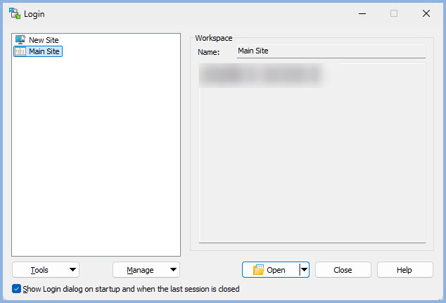

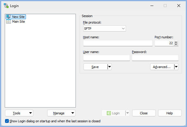

If I click the New Site button, I see an Advanced button. I do not see that if I click on the site I created. How do I change any of its settings please?

Please post a screenshot of what you see.
The Advanced button should never be hidden. It is only disabled, if stored site is selected and is not being edited.
Also there's no New Site "button". Do you mean the New site "item/node" in the sessions tree?

It begs the question as to why have workspaces where various settings cannot be changed. Maybe in an office environment an admin can set up a workspace so that a user can do whatever without knowing the password and so on?
Can I stop the workspace automatically opening or is that perhaps also part of the reason for having them?
Many thanks for the help you have given this newbie.
A workspace is a set of sessions/tabs. You might have different workflows, and you might want to have separate workspaces for each.
The workspace should not automatically open, as you have the "Show login dialog on startup..." checked. Or is it? Can you post a screenshot of WinSCP after you start it?
I believe it's all documented here:
https://winscp.net/eng/docs/workspace
