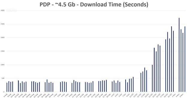

Our automated download of about 70 files (4-5 Gb of data nightly) has recently slowed significantly. We were seeing roughly 6–7 minutes total download time which has slowly moved into the 40–45 minute area. I spoke with a network tech at our vendor who said they handle 100's of customers downloads and they are averaging 55Mb/sec. We were at 8–10, but are now are seeing 1–2.
We were running the WinSCP Module in PowerShell and when it slowed to 45 minutes, I tried re-coding using the WinSCP.exe so I could take advantage of the -rawsettings and implement some of the suggested solutions (most notably trying Blowfish and Sendbuf=0). Our run of this code was also in the 40 minute range. The network team here worked with me to do a test from the same machine internally to one of their externally hosted (over the internet like our vendor) sites and we achieved ~20MB/sec in our test.
I'm hoping there is a setting I'm missing that will work with the specific host we are hitting as our test run demonstrated that we are not bandwidth limited.... and the vendor demonstrated they are handling multiple clients at the same time of day and pushing at high speed.
Code has been simplified to the pull portion only as none of the other logic is time consuming and the logs show the time is all related to download speed.
If there is a setting that will get us flying again, you'll have my gratitude (and some nerd points).
I've attached Session and Debug logs as well as the output log from our full script and a graph showing the behavior (it has been a slow progression of performance degradation).

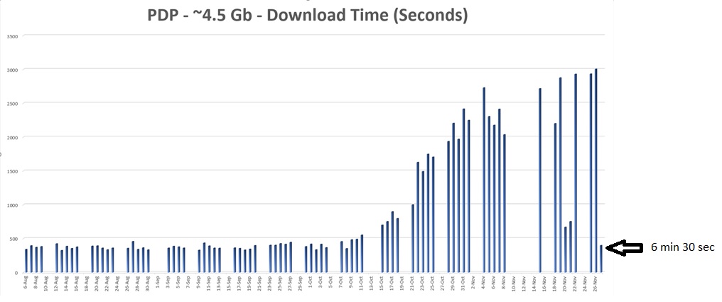

It looks as though my code change had no impact on the performance. It was simply a coincidence. The downloads are back at 45-50 minutes for 4.5Gb. I think I'm just going to live with it. I'll take reliability over speed any day. I have no idea why I got an 11 minute night or why its back at 45, but I'm just going to have to move my focus back to other projects. Thank you for your input and WinSCP education.

Martin ..
I believe it is back to its original speeds!
I had been hopping between code versions and I think I used one where Compression was set to 0. The changes have worked (I also added in SFTPDownloadQueue at 128) – I think I didn't see the impact of the changes as I was using the wrong code version (the one with Compression off).
So, below is the current version of raw settings that I'm using that resulted in WinSCP pulling 70 Files Totaling 4.70 Gb in 6 Minutes and 38 Seconds. Great numbers. :) Whatever the root cause of the slow loss of download speeds, the raw settings now in place have me back where I was prior.
$F25sessionOptions.AddRawSettings("Compression", "1")
$F25sessionOptions.AddRawSettings("CacheDirectories", "0")
$F25sessionOptions.AddRawSettings("CacheDirectoryChanges", "0")
$F25sessionOptions.AddRawSettings("SFTPDownloadQueue", "128")
$F25sessionOptions.AddRawSettings("Cipher", "arcfour,blowfish,aes,3des,chacha20,WARN,des")
$F25sessionOptions.AddRawSettings("PreserveDirectoryChanges", "0")
$F25sessionOptions.AddRawSettings("SendBuf", "0")
$F25sessionOptions.AddRawSettings("SshSimple", "0")
Many, many thanks for your help and the great documentation. I'm finally putting this one to bed.
Description: Nightly Download Speed - FIXED!
