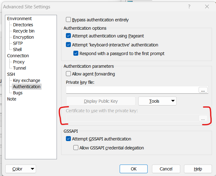

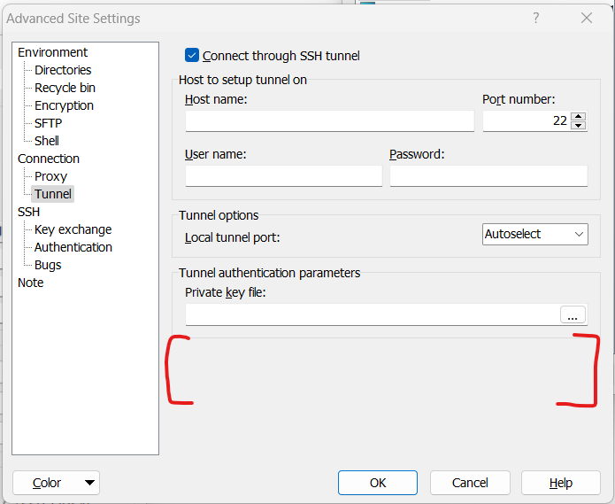

Can the option for a certificate please be added to the Tunnel settings as there is on the Authentication page?
I am using Azure temporary SSH keys, and when WinSCP converts them from OpenSSH format to ppk that doesn't bundle in the accompanying certificate that is required.
Description: Certificate option to use with private key
Description: Option to use certificate to use with private key is missing
