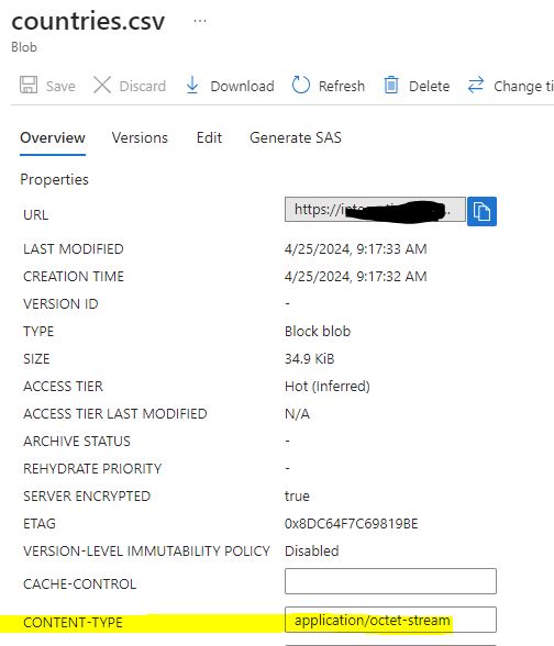

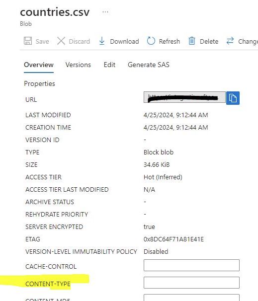

As I understand, the Azure Storage SFTP interface defaults content-type to application/octet-stream, and earlier the files we uploaded using WinSCP got the default-content-type but not anymore.
I wrote a C# console app using the Renci.SshNet-package, and when uploading files through this app, the content type was set to the default content type.
Attaching images of blob-properties using WinSCP and Renci.

Thanks. After some tests, it seems that the SSH_FXP_SETSTAT SFTP request clears the content type on Azure. It seems like a bug in Azure SFTP.
WinSCP uses that request to update the timestamp and/or permissions of the uploaded file.
So either something has changed on Azure side recently, or you had the "Preserve timestamp" (and "Set permissions") turned off before and now you have either of them on.
https://winscp.net/eng/docs/ui_transfer_custom
Turn both off. Or talk to Azure support.
