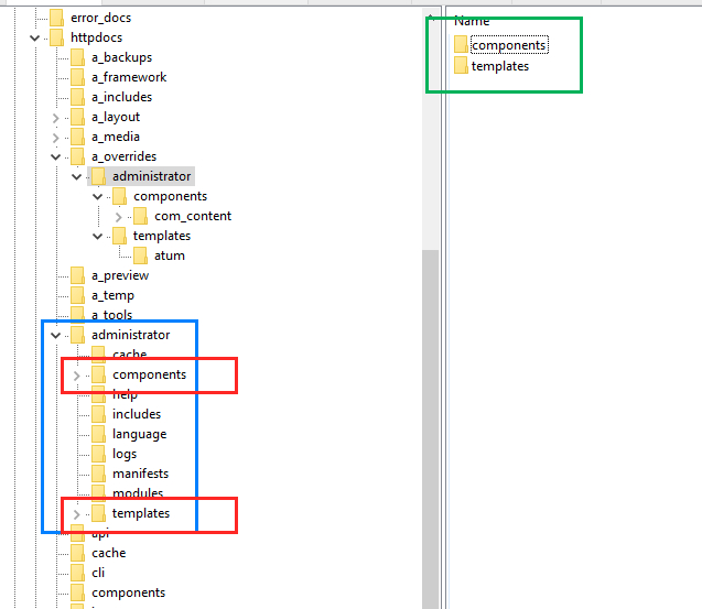

Hello Martin,
thank you for you fast reply. I drag from "right remote dir" to "left remote tree" (both on same server).
I copy marked green folders with Strg/Cmd into blue one / after dropping then the red folders are emptied and contain only my override files from green – what is not the usual behaviour.
Check the attached image please.

I mark in the green folders and drag them in tree into that blue one.
Red folders have of course lot of folders inside. But once I drop greens into blue then red are complete empty and then there are only that folders left that are contained in green.
They get emptied. I can shere AynDesk with you and show you...
