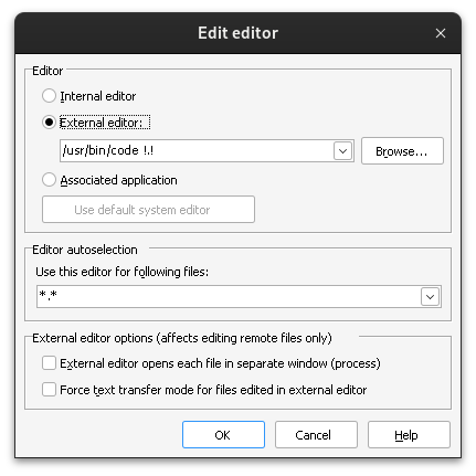

External editor doesnt open files.

Are you running WinSCP under Wine?
Post application log (use /applog=path command-line argument).
43,035
Re: External editor doesnt open files.
[2024-02-11 13:07:17.808] [4EC] Executing program "/usr/bin/code" with params: "C:\users\yeleha\Temp\scp07408\mods\deathmatch\resources\[Slovak RolePlay]\[Main]\achievement\achievement_c.lua"
[2024-02-11 13:07:17.821] [4EC] Opened external editor with remote file "C:\users\yeleha\Temp\scp07408\mods\deathmatch\resources\[Slovak RolePlay]\[Main]\achievement\achievement_c.lua".
[2024-02-11 13:07:23.807] [4EC] Deleted opened/edited file [C:\users\yeleha\Temp\scp07408\mods\deathmatch\resources\[Slovak RolePlay]\[Main]\achievement\achievement_c.lua] folder "C:\users\yeleha\Temp\scp07408\".
Did you close the editor at 13:07:23? Or was the file deleted prematurely? Maybe you need to uncheck "External editor opens each file in separate window (process)":
https://winscp.net/eng/docs/ui_editor_preferences
So the editor opens – But it does not open the file?
Isn't the problem the square brackets in the file name? Does it work with more conventional file names?
