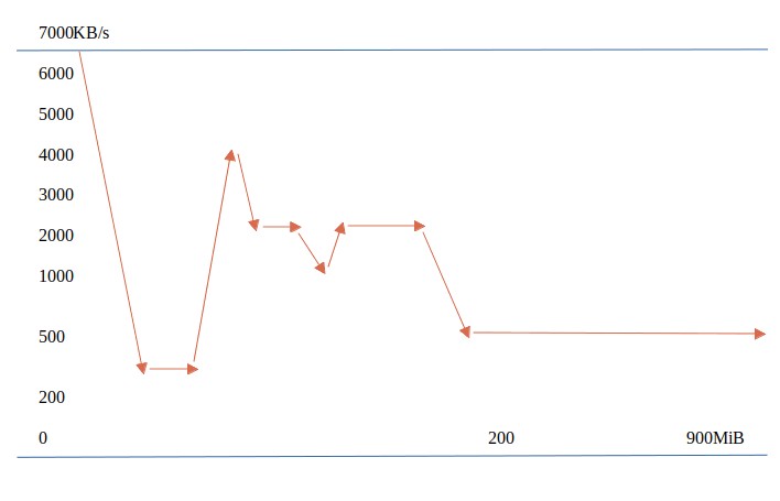

6433567
FTP, SFTP, SCP
I can show again, but it's not required. The speed starts from high and drops to 500-200 KB/s, but rises to 200-7000 KB/s for a short time and falls again. If I take a larger example file, the speed on some segment of the downloaded file will drop to 500-200 KB/s for a constant time and the average speed will be lower in the log. I think in the log, the average download speed is shown. But I'm not sure 100%.
Everything is the same as in the previous examples 500-200 KB/s (except guest). With SFTP (ARM) between AES and C.20, not only the speed is different, but the CPU load is different. Which is not the case with SCP between AES and C.20.

6433567
@martin: Only this:
