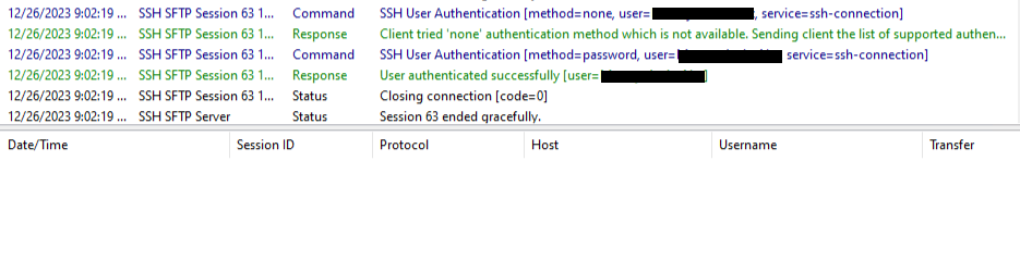

It's not transferring the .csv file from my PC (Client) to the remote server when I run the batch command.
When I open WinSCP and look at the administrator screen it shows that we connect just never sent the file.
THanks
