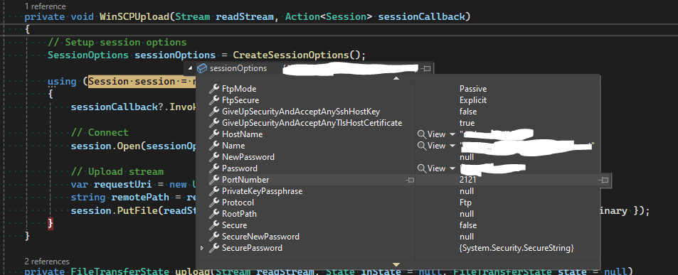

I try to uploading larger files over FTP (MB and GB) and FileProgress always report only 0 and 1.
Hove
4
For the entire operation of upload/download it calls FileTransferProgress but with FileProgress=0 until it finishes the upload, then it calls again multiple times incrementing FileProgress all at once. Keep in mind that I am running this operation on background thread (not STA), using Windows Desktop WinForms .NET 8 project and connecting to FileZilla Server 1.8.
session.FileTransferProgress += (s, e) =>
        if (fileTransferState.Canceled)
            e.Cancel = true;
        fileTransferState.BitesWritten = (long)(fileTransferState.StreamLength * e.FileProgress);
session.PutFile(readStream, remotePath);
