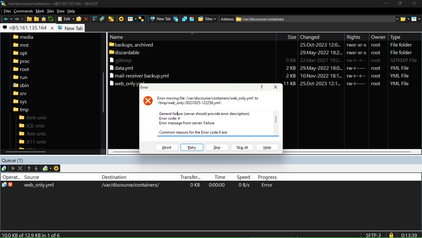

Even when I'm logged in as a root user to my remote Ubuntu22.04 server thru WinSCP 6.1.2, I get this error when I save a changed file (even though I found that the changes made by me are saved in that file, but these errors irritate).
See the screen shot here: https://i.stack.imgur.com/egbR0.png
The contents of the error (also showing partially in the attached screen shot) are:
General failure (server should provide error description).
Error code: 4
Error message from server: Failure
Common reasons for the Error code 4 are:
- Renaming a file to a name of already existing file.
- Creating a directory that already exists.
- Moving a remote file to a different filesystem (HDD).
- Uploading a file to a full filesystem (HDD).
- Exceeding a user disk quota.

How can we make use of Recycle bin option in WinScp, when WinScp is installed on Windows on local pc
I've WinSCP installed in Windows 11.
When I login to remote Ubuntu server, and turn on the option to use the 'Temp' folder as the 'Recycle Bin', and delete a file, it starts giving "Error 4: Server Failure" or something like that.

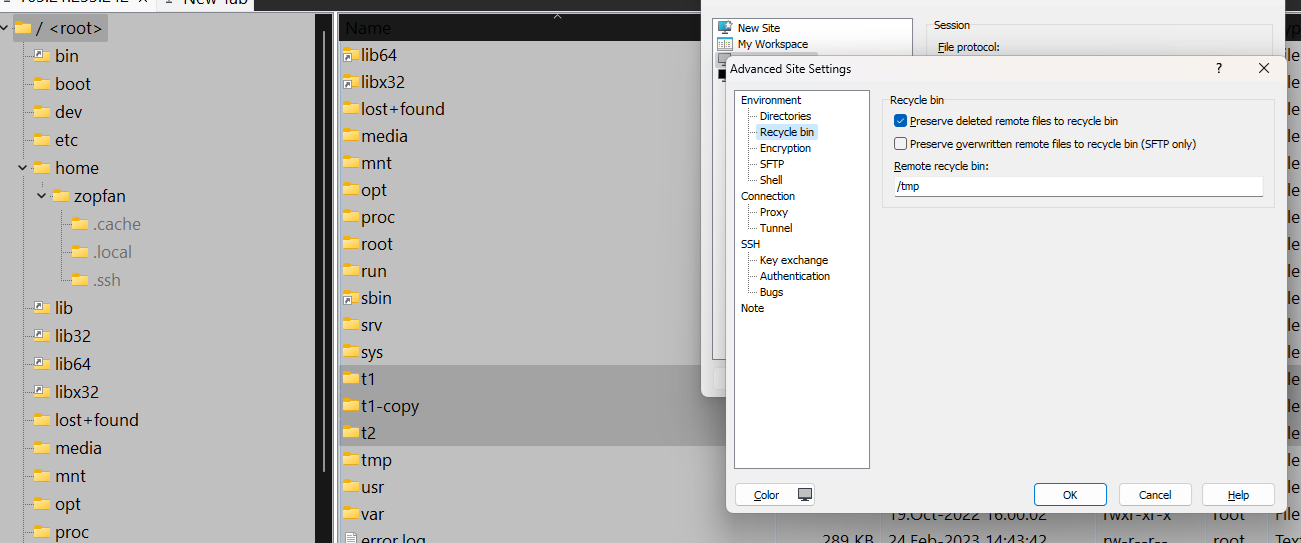

I created the /tmp folder in my remote linux server (actually it was already there) and in the site preferences I gave the path to recycle bin as /tmp.
But still I get the same error as mentioned in earlier/OP.
See attached screenshot.
So you didn't actually change anything, right?
As I wrote above, the /tmp is probably on a different remote file system than the files you are deleting. You have to create the recycle bin folder on the same remote file system.

I know. But the remote system most likely has multiple file systems (for example multiple disks). And the /tmp is likely on a different one that the files that you work with. In general, you cannot move files between two different file systems (disks).

I mean that the recycle bin directory have to be on the same file system (disk) as the files you want to move to the recycle bin.

If you don't mind me interjecting. To look at it backwards, if it doesn't work, then the path location of the recycle bin is not a correct location for use. According to Martin, you can't use just any location.
Try a different location. /tmp is an example path. Try something else like in the path of the file you're trying to recycle.
