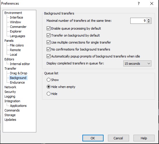

I have tried setting up the multiple connections for transferring from local to remote and vice versa but I appear to not be having any luck. I say this mainly because when transferring, although it appears that multiple files are transferring at the same time, they don't appear to have independent connections much like when you drag and drop one file or folder after another. If this is just visually how things look, then let me know...

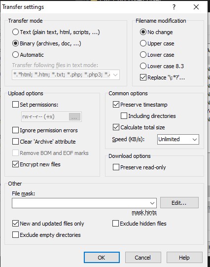

NOTE: I saw the fact multiple files don't transfer when the include directory timestamp option is selected.

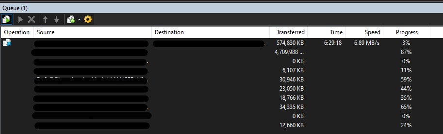

I have attached the example I am referring to when I say "appears to be transferring multiple files". To me it appears as though the files are all being transferred simultaneously but that they are all being transferred at the same speed cap and therefore not new connections. (essentially the same speed it would be if I transferred the individually).

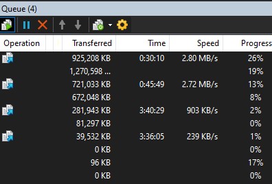

Comparatively, I will also attached an example of what it looks like when I individually drag items across. I have noted the speed appears capped at a total as the same cap for the full transfer so I am genuinely lost. Any input on how to Improve either the total transfer speed for an "multiple transfer" or the individual transfers will be greatly appreciated. (I do know I may be limited by the transfer speed of either end of the transfer but I do not believe this to be the case and if there's a way to see this, other than what has already been attached, this would also help)

So what did you expect differently? In general, I wouldn't be surprised if six paralel transfers/connections (your second screenshot) already saturate your bandwidth (or CPU or whatever the bottleneck is). So adding another three connections (your first screenshot) won't give you any advantage.

The 6.89 MB/s in your first screenshot is cumulative speed of the 9 transfers.
The speed can be capped for example by CPU (CPU core specifically), in which case it would be the same (assuming the same algorithms etc) even over different networks.
