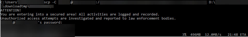

I am currently having big problems with the transfer rate if I am using WinSCP via SCP to download files from a Linux server to a Windows server.
If I use the build in SCP.exe from Windows, I get 12MB/s.

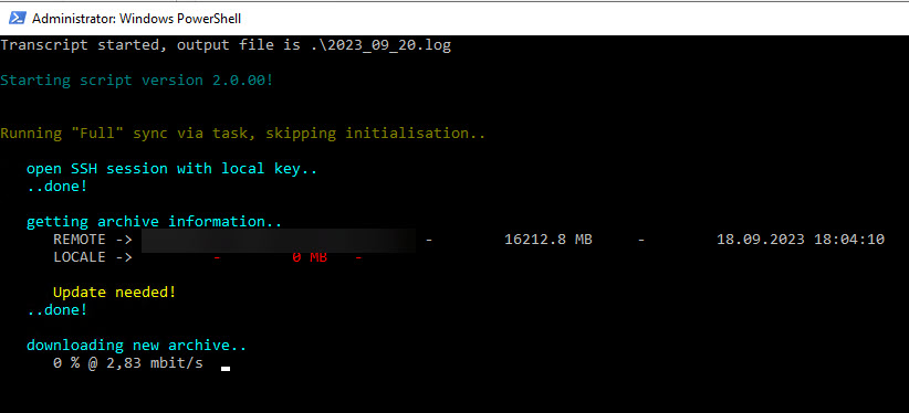

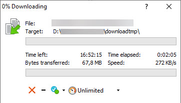

If I use WinSCP GUI or the .NET Assembly in PowerShell I get about 2-7 mbit/s and less.

EDIT: Just found a solution.. Disabling the "Optimize connection buffer size" help a lot here.
https://winscp.net/eng/docs/ui_login_connection
Question is how I can do this for the .NET Assembly?
EDIT2:
Setting these options fixed my problem in the powershell script:
$sessionOptions.AddRawSettings("SendBuf","0")
$sessionOptions.AddRawSettings("SshSimple","0")
