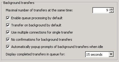

Hello.
I have setting "Maximal number of transfers at the same time" = 9 and expected, that when I transfer a directory (in background), 9 files from it will be transferred at the same time. But this is not the case: only 1 file is transferred ((
But if I manually split the files between 9 tasks – they all will work together.
What I do wrong? Why single background task is not distributed among 9 transfers?

Making some experiments, I've found the source of problem.
I've started several background tasks, one of them realized (!) multi-file transfer, others -- not :((. The difference was in Transfer Settings.
The one, that performs multi-file transfer, had default "New and updated files only" settings, the others have added "Preserve timestamps, Including directories" and have "Exclude directories" file mask set. As I just added the file mask, I think that the problem is in "Including directories" option.
Am I right?

Re: Multi-file background transfer doesn't work
Yes, multiple connections are not used, when preserving timestamps of directories is enabled:
https://winscp.net/eng/docs/ui_pref_background#multiple_connections
You can increase the limit beyond 9 with raw configuration option Interface\QueueTransferLimitMax:
https://winscp.net/eng/docs/rawconfig#queuetransferlimitmax
But I do not recommend it for stability reasons.
