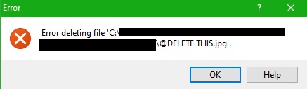

Requested Steps
- Select file from display of local folder
- Press delete key
- Question appears: "Are you sure you want to move file '@DELETE THIS.jpg' to recycle bin?"
- Press OK button
- Error appears: "Error deleting file 'C:\...\@DELETE THIS.jpg'" (I have replaced the actual path in this display with an ellipses for privacy purposes. The path is correct.)

Error Message
That is the complete error message. See the attached image.
Error Disappeared
I reverted to V5.21.8 and was able to delete a file. I then re-installed V6.1 and was still able to delete a file. Gremlins?
