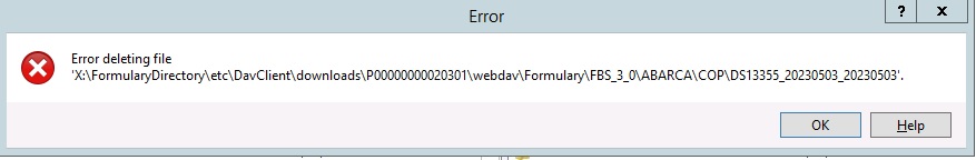

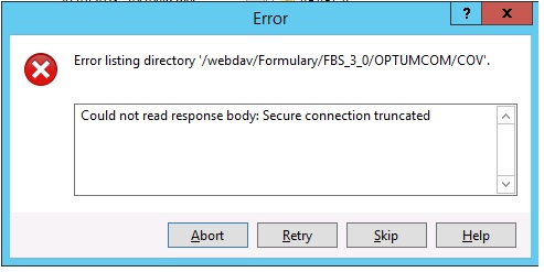

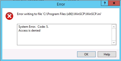

I switched to using the Console instead of a batch file for debugging purposes. Been running into lots of issues. The latest is this error deleting a file, which I've run into 3 times today. I checked the file and its not open by any other process. Its also not read-only. From File Explorer, I deleted it without any problem.
Sorry, I'm lost. Those are GUI windows. Not console. What are you doing now? How did run WinSCP when you get those errors?
johnmsch
36
Atlanta
My apologies, I must be using the wrong terminology.
To me, there are two ways to run WinSCP. A batch file, which I've been using all the past years and the GUI, which I have been referring to as the "Console".
Is there a 3rd way to use WinSCP called Console?
At any rate, the above latest examples are from using the GUI. I thought that for debugging purposes, I would use the GUI instead of just using my old batch file process.
Thank you
I'm not sure your GUI errors are related to your batch errors.
I'd suggest you rather follow the debugging guide, I've posted earlier.
