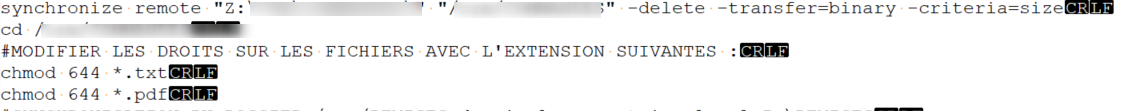

I made a script who synchronize a local folder to a remote folder: it works fine
After I execute a chmod 644 on all files with extensions *.pdf for example: it works but it take long time because it change the permissions for all files: the new ones and the olders who already have the good permissions.
Is it possible to "filter" the chmod only to the new files I just synchronized? Like files who are modifies under 24hours for examples?
Thanks

I already try the -permissions but it doesn't work, I guess it's because I use FTP and not SFTP?
