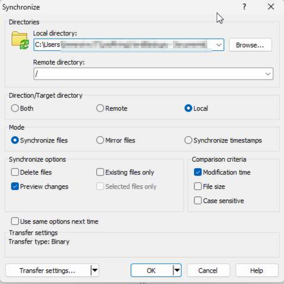

I am trying to achieve a simple automation synchronize command. I want to copy all files from root of a remote server to local c:\folder but when I run the command through task scheduler it is trying to send c:\windows\system32 to the remote server.
If I run a manual sync from WinSCP app it works fine.
I have attached picture of command being used with redacted fields. Also I have tried putting / as the root after synchronize local command.
Nilks
If you see attached it works when done through the APP. I want to run Task Scheduler and automate this. But When I try it is trying to upload Windows\system32 to remote side.
I need to copy files from REMOTE to Local.

What command would I use for what is showing in the image above.
I want to copy every file from REMOTE (/) to LOCAL (user\.....) This would run every day in the morning hence using Task Scheduler.
