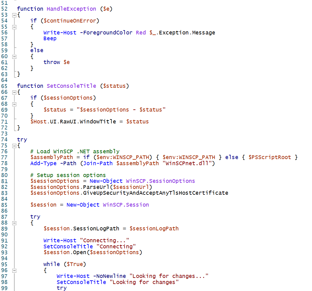

Anyway, if you want to trust this certificate, set SessionOptions.TlsHostCertificateFingerprint.
Or if you want an equivalent of the insecure -certificate=*, use SessionOptions.GiveUpSecurityAndAcceptAnyTlsHostCertificate.

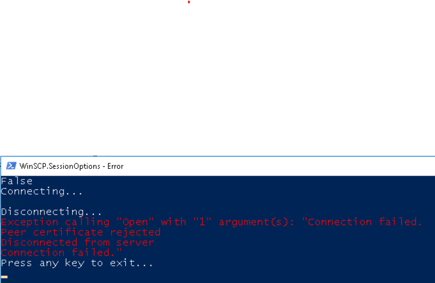

I've now tried adding the session options. it gives me back the same error.
The not its printing "false" before connecting... i guess I'm doing something wrong here..
Please see attached files.
Description: script
Description: error code
