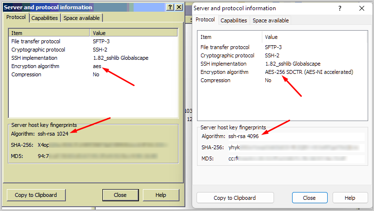

This application is installed and working in many Windows computers. I notice that, in (at least) one of them, the following error message:
Host key does not match configured key fingerprint "ssh-rsa 4096 cc:f0:**:**:**:**:**:**:**:**:**:**:**:**:**:**"!
Host key fingerprint is ssh-rsa 1024 X4op****************************************.
Authentication failed.

I also ran the same WinSCP.exe version with the same .ini configuration in both computers and got the same behavior.
So I'm wondering what could be the cause of getting the "ssh-rsa 4096" host key in most installations and the "ssh-rsa 1024" in some of them.

Re: Same SFTP server returning different host key fingerprints
The difference in "Encryption algorithm" display details actually imo show that you are using different versions of WinSCP. The simple "aes" was shown up to WinSCP 5.19.5. Since WinSCP 5.16, the more detailed format is used.
Make sure you upgrade to the latest version of WinSCP everywhere.
If you still have problems afterwards, please post session log files from both systems.

I double checked the WinSCP versions. They are indeed equal, but old v5.13.7.
I tried using WinSCP v5.21.7. The description is different, but unfortunately the behavior is the same.
So I collected logs from a place where the algorithm is "ssh-rsa 4096" and a place where it is "ssh-rsa 1024".
The only meaningful difference I notice is that they connect to different IP addresses, despite using the same URL. Maybe they reach different servers with different keys!?
  • logs.zip (4.59 KB, Private file)
Well, you have removed all host information from the logs. So we can hardly help you about the IP addresses. If you are 100% sure that you connect to the same hostname on both macvhines, then the problem is likely in the DSN resolution on those machines. Did you try to ping the host names on both machines, to see if they resolve the the same IPs? Or you can use the IP instead of hostname in WinSCP.
