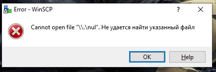

Hello! A problem when opening a session, and on some computers. When viewed in the debugger, I found that the error appears if HomePath throws an exception. If HomePath = "\" then everything is fine. Tell me what can be done? Attached is the debug log and a screenshot of the error.

On the computers where the code fails, what happens if you run:
winscp.com /ini=nul /command "echo test" "exit"

Hello! Used a new assembly of the library, running through the command line as indicated above. At the first start there were no errors, the word test appeared. But the second and subsequent runs result in the same zero error. I am attaching the log file.
  • WinSCP5144trace.log (95.68 KB, Private file)
