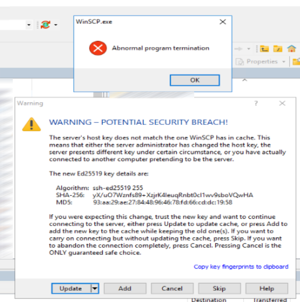

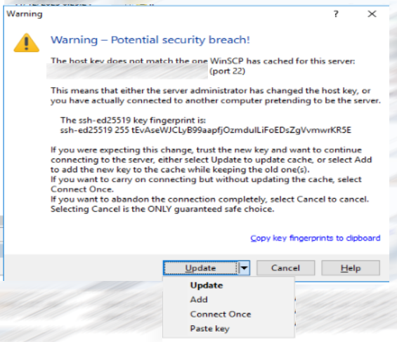

Hello!
I'll continue this topic if you are not afraid.
I have the same issue with another one (6.1.1 – SFTP – Abnormal program termination).
Each issue appearing randomly from time to time and both (I have to move big data and don't watch process all the time, but when I check progress I see one of this issue or both).
It appearing both on 6.1.1 and 6.2 beta.
On the source side I have Windows Server 2019 std eng and on destination side – rhel x86_64 8.7 w/o any LB & NAT (connection from source to destination is through L2 network).
Screenshots of errors attached.
If it isn't possible to fix this issues is it possible to add option "Always Add" or "Always Update" for workaround of this issue?

@d3nz: Please attach a full session log file showing the problem (using the latest version of WinSCP).

Hi Martin.
I turned on logging and will share logs with as soon as interactive window will appear.
Btw maybe it some related to several sessions (tabs) to same host and using same username?
I'm uploading big data by folders with many files in it.
