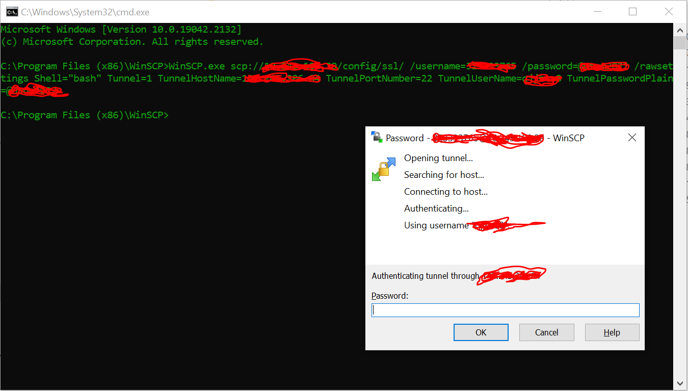

I use this command to connect to server by SCP through tunnel, but the command didn't take the TunnelPasswordPlain settting, it still ask me to put password manually, can you please tell me why? My command is like below:
C:\Program Files (x86)\WinSCP\WinSCP.exe scp://1.1.1.1/config/ssl/ /username=my_usn /password=my_pwd /rawsettings Shell="bash" Tunnel=1 TunnelHostName=8.8.8.8 TunnelPortNumber=22 TunnelUserName=my_tunnel_usn TunnelPasswordPlain=my_tunnel_pwd
Thank you very much,
James

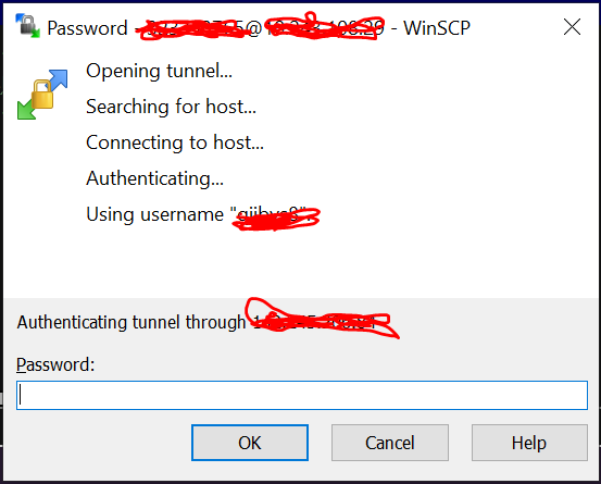

jsszheng
I still got Tunnel password prompt
Thanks Martin, I can start the WinSCP without issue, so quote should not be an issue, it just didn't take the TunnelPasswordPlain="mytunnelpwd". I pasted the log and attached Tunnel Password Prompt screenshot above for your reference. What version did you test and tunnel password was taken?
Thanks,
James
jsszheng
If I put tunnel password manually the session will be connected
More information, if I type tunnel password manually on the prompt then the session will be connected automatically.

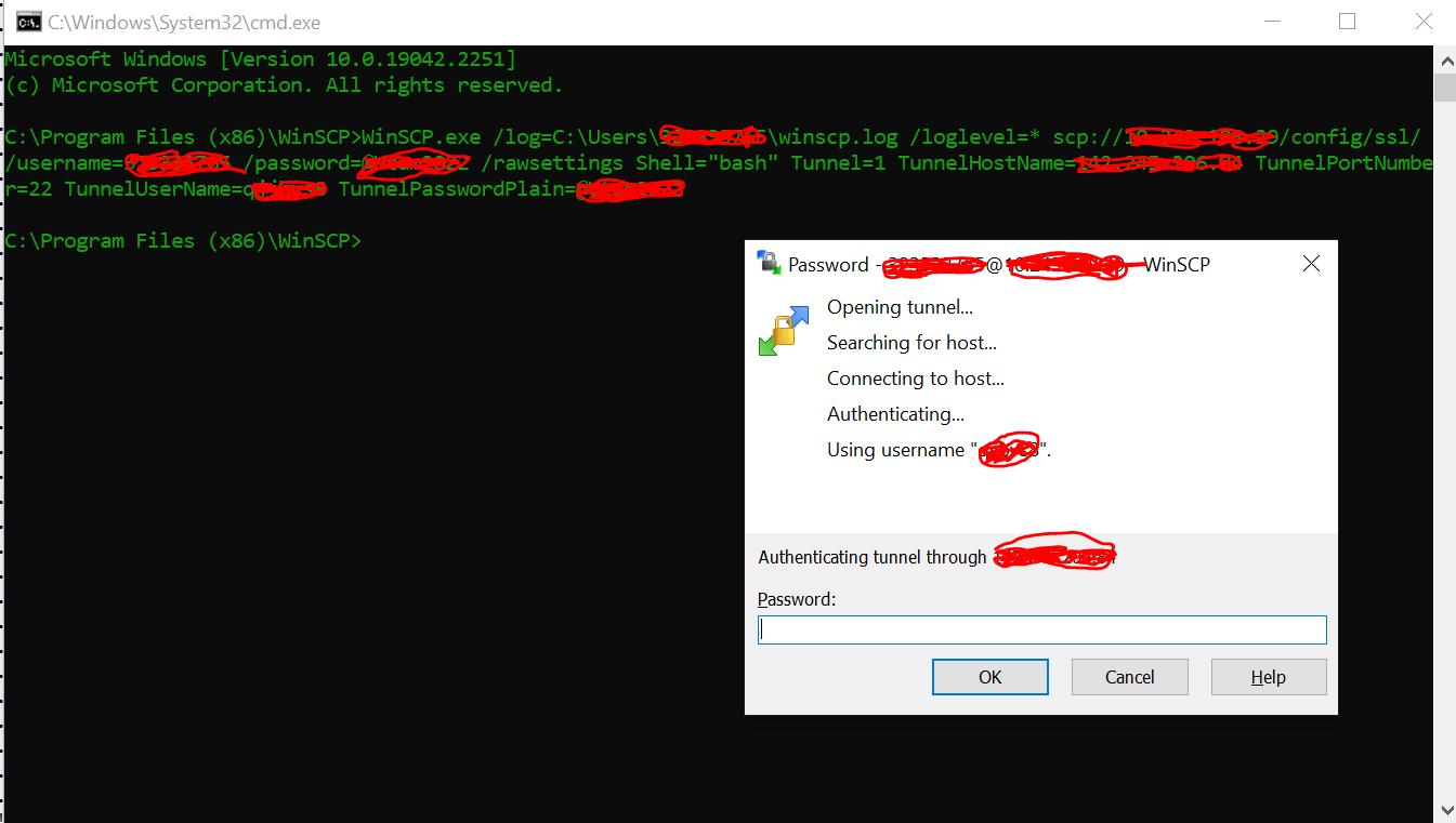

If I run your exact command (just with enabled password logging):
WinSCP.exe /log=winscp.log /loglevel=* scp://example.com/config/ssl/ /username=username /password=password /rawsettings Shell="bash" Tunnel=1 TunnelHostName=tunnel.example.com TunnelPortNumber=22 TunnelUserName=tunnelusername TunnelPasswordPlain=tunnelpassword
I see in the log that the tunnel password is taken correctly:
. 2022-11-21 12:59:31.073 Tunnel: User name: tunnelusername (Password: tunnelpassword, Key file: No)
What do you get in the log if you do the same? Using the latest version of WinSCP (though I seem to be getting the same results even with 5.21.2).
jsszheng
Re: Command-line didn't take the TunnelPasswordPlain="tunnel_pwd"
Thanks Martin, it still didn't take the password, still prompted for tunnel password, please see the log below:

. 2022-11-21 23:03:31.828 [Tunnel] Connected to 2.2.2.2
. 2022-11-21 23:03:31.850 [Tunnel] We claim version: SSH-2.0-WinSCP_release_5.21.5
. 2022-11-21 23:03:31.850 [Tunnel] Connected to 2.2.2.2
. 2022-11-21 23:03:31.864 [Tunnel] Remote version: SSH-2.0-OpenSSH_7.4
. 2022-11-21 23:03:31.864 [Tunnel] Using SSH protocol version 2
. 2022-11-21 23:03:31.867 [Tunnel] Have a known host key of type ssh-ed25519
. 2022-11-21 23:03:31.913 [Tunnel] Doing ECDH key exchange with curve Curve25519 and hash SHA-256
. 2022-11-21 23:03:32.013 [Tunnel] Server also has ecdsa-sha2-nistp256/rsa-sha2-512/rsa-sha2-256/ssh-rsa host keys, but we don't know any of them
. 2022-11-21 23:03:32.013 [Tunnel] Host key fingerprint is:
. 2022-11-21 23:03:32.013 [Tunnel] ssh-ed25519 255 SHA256:1pzORLAq4va5if55iIs2NVD4fXVNkRzP0uUFS38FJds
. 2022-11-21 23:03:32.038 [Tunnel] Host key matches cached key
. 2022-11-21 23:03:32.040 [Tunnel] Initialised AES-256 SDCTR (AES-NI accelerated) [aes256-ctr] outbound encryption
. 2022-11-21 23:03:32.040 [Tunnel] Initialised HMAC-SHA-256 outbound MAC algorithm
. 2022-11-21 23:03:32.040 [Tunnel] Initialised AES-256 SDCTR (AES-NI accelerated) [aes256-ctr] inbound encryption
. 2022-11-21 23:03:32.040 [Tunnel] Initialised HMAC-SHA-256 inbound MAC algorithm
! 2022-11-21 23:03:32.066 [Tunnel] Using username "mytunnelusername".
. 2022-11-21 23:03:32.121 [Tunnel] Server offered these authentication methods: publickey,gssapi-keyex,gssapi-with-mic,password
. 2022-11-21 23:03:32.121 [Tunnel] Using SSPI from SECUR32.DLL
. 2022-11-21 23:03:32.121 [Tunnel] Trying gssapi-with-mic...
. 2022-11-21 23:03:32.121 [Tunnel] Attempting GSSAPI authentication
. 2022-11-21 23:03:32.146 [Tunnel] GSSAPI authentication request refused
. 2022-11-21 23:03:32.146 [Tunnel] Server offered these authentication methods: publickey,gssapi-keyex,gssapi-with-mic,password
. 2022-11-21 23:03:32.146 [Tunnel] Prompt (password, "SSH password", <no instructions>, "&Password: ")
. 2022-11-21 23:03:32.146 [Tunnel] Prompting user for the credentials.
Description: run from cmd

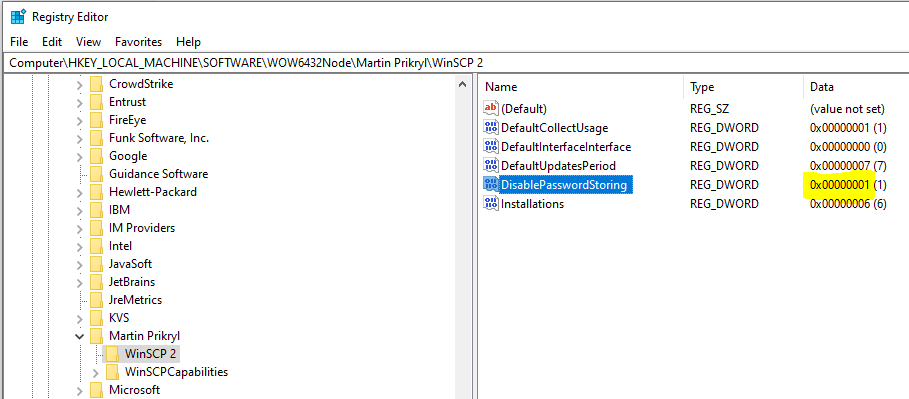

Thanks Martin, yes I have password disabled setting on registry, I have no permission to change it. Is this the reason? But why was session password taken? Only tunnel password was not taken.
