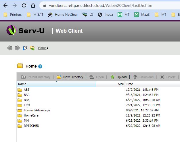

I'm uploading a session log. I'm also uploading Capture.jpg. This shows a screenshot of the folders I can see when I access the SFTP server via a browser. When I use SCP I can't see the MM folder or the RPTSCHED folder. I also tried FileZilla and it behaves the same as SCP. But the vendor assures me the folders are all set up the same. Thanks for your input.
Description: Screen shot of folders available via browser.
Description: Session log of attempt to access MM folder.
Re: Some folders not visible in GUI or via script
I was asking for "session log of the GUI session that fails to display some [MM] folder". Though if FileZilla does not display the folder either, then it's most likely a problem on the server-side anyway. That some web-interface displays the folder is not really relevant.

What does it mean "resync the sftp"? Maybe they believe that WinSCP caches the directory contents. It does within one session, but I assume you have connected few times already and the folder is still not there, right? And the script log clearly shows the server claims the folder is not there (assuming the /MM path it correct – Is the folder in the root, right? – GUI log would be better for confirm that).

< 2022-09-01 14:29:54.640 Type: SSH_FXP_NAME, Size: 538, Number: 2828
< 2022-09-01 14:29:54.640 68,00,00,0B,0C,00,00,00,06,00,00,00,03,41,42,53,00,00,03,BD,02,00,00,00,00,
The highlighted part of the response from the server shows that it returned 6 entries. And 6 entries did WinSCP decode from the response:
. 2022-09-01 14:29:54.640 ABS;D;0;2021-12-02T18:51:48.000Z;4;"user" [0];"group" [0];rwxrwxrwx;1
. 2022-09-01 14:29:54.640 BAR;D;0;2021-09-15T17:24:57.000Z;4;"user" [0];"group" [0];rwxrwxrwx;1
. 2022-09-01 14:29:54.640 BBK;D;0;2022-06-24T14:50:48.000Z;4;"user" [0];"group" [0];rwxrwxrwx;1
. 2022-09-01 14:29:54.640 ECM;D;0;2022-07-21T16:30:51.000Z;4;"user" [0];"group" [0];rwxrwxrwx;1
. 2022-09-01 14:29:54.640 ForwardAdvantage;D;0;2021-08-04T14:22:52.000Z;4;"user" [0];"group" [0];rwxrwxrwx;1
. 2022-09-01 14:29:54.640 HomeCare;D;0;2021-12-09T17:26:22.000Z;4;"user" [0];"group" [0];rwxrwxrwx;1
And that's it. There's nothing more. No MM. The server does not return it.
The server uses SFTP version 6, which is rarely used. Many clients do not support it. So it's quite common that implementation in servers is buggy, as it is not well tested. Sometimes, forcing lower version (3) can help. Try it. But I do not really expect it to help, as you have same problems with FileZilla. And FileZilla does support version 3 only.
