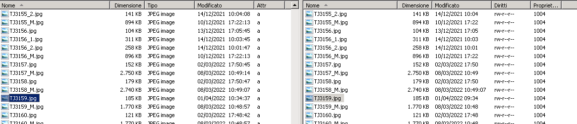

Hi, I don't know why, but for some transferred file from local to remote, either manually and by sync script, the file time changes, and some other times the seconds are added, but most of the times not. The strange fact is that this happens only for some file, really few, and working with synchronization by date and size, this means that some file are always transferred.
I've added a screenshot, so you can see this, and as you can see, it happens only for few files (every time the same files).

Please attach a full session log file showing the problem (using the latest version of WinSCP). Give us a name of one file for each behavior.

Thanks. Though I was asking for "one file for each behavior". You gave me loads of names, presumably for the "Wrong file time" behavior only.
Though actually I do not see same behavior for these. Randomly picking EW0240_2.jpg and TW1943_2.jpg, the first is not synchronized while the latter is.
Taking a look in more details at the synchronization of TW1943_2.jpg: Imo, WinSCP behaves correctly. To debug this further, I'd probably need a log for the consecutive synchronization. In which, if I understand the problem correctly, the file is synchronized again, despite being synchronized before already.
