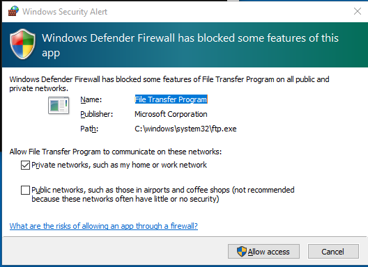

In the above reply I forgot to mention an error popup which occurred when running Windows FTP from the command prompt (screen grab attached). Having ticked the box to allow public networks I successfully completed the interactive and scheduler tests described above.
I emphasise that WinSCP had never displayed any such error message and worked successfully interactively (GUI or command script).
Later I went back and re-tried the scheduler script described in the original post.
This now works as expected from a logged off sleep mode PC.
So two questions:
1 How could WinSCP run successfully interactively without issuing the message issued by Windows FTP/Firewall
2 As this seems to have been the issue that gave rise to my original post why was it not reported in some form in the log file.
But all now seems OK
Thanks for the pointer on troubleshooting.
Description: Windows FTP error popup
Re: Windows 10 FTP transfer connection failed
Windows ftp supports an active FTP mode only. In the mode the client have to listen for incoming connections, when transferring files and listing directories. That's what I believe did trigger the firewall popup, because it needs the incoming port to be opened in the firewall. On the contrary WinSCP (and basically all other FTP clients) uses passive mode by default. And you did not even connect with WinSCP. WinSCP never got to the point of transferring files or listing directories.
See also https://winscp.net/eng/docs/ftp_modes
Also confirming that popup creates firewall rule for ftp.exe only anyway. It should not have any impact on other applications.
So this should not be related at all. But hard to tell...
