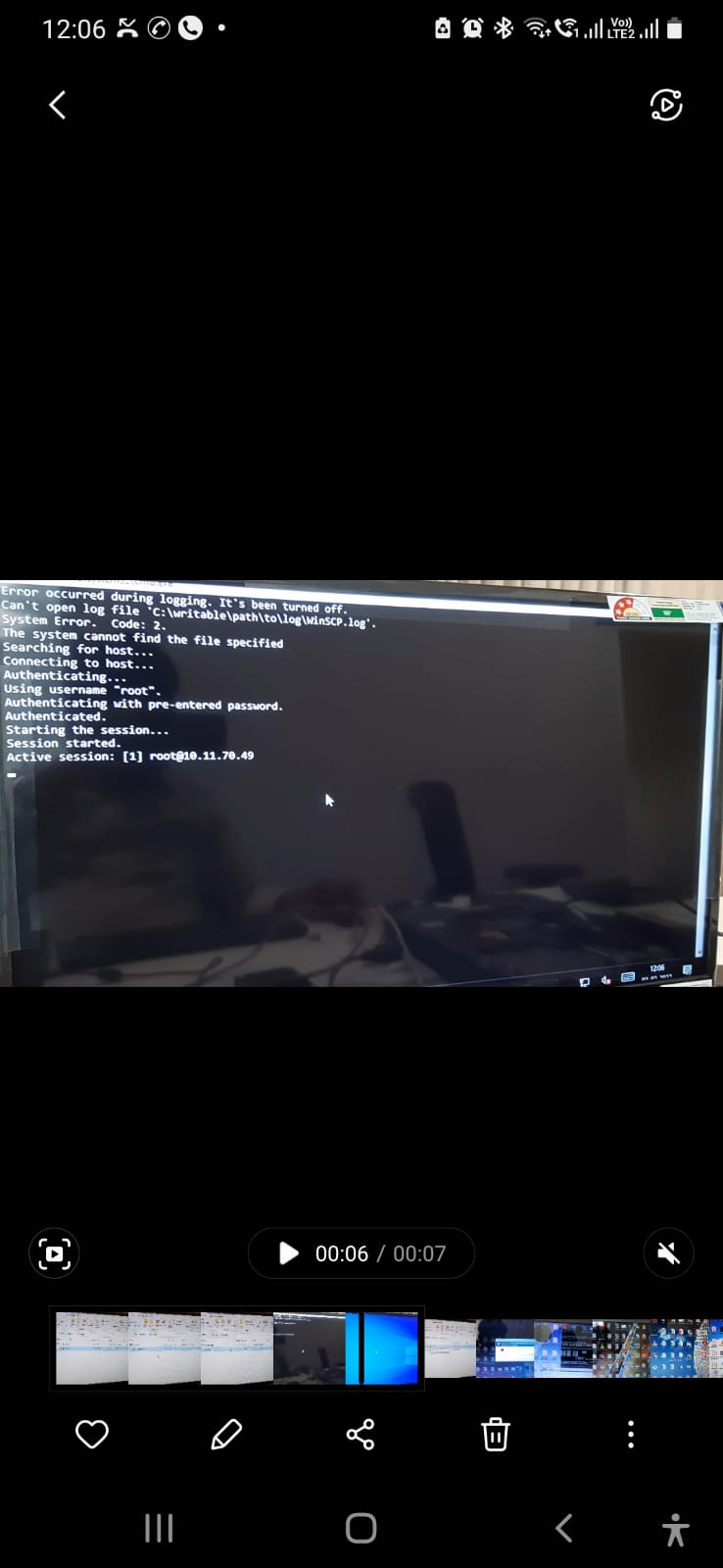

My script is not getting executed, it is getting connected and starting the session and getting
@echo off
  /log="C:\writable\path\to\log\WinSCP.log" /ini=nul ^
  /command ^
    "open sftp://root:ikea%%40123@10.11.97.171/ -hostkey=""ssh-ed25519 256 2bK9x/+PkrDrpa6xfu+556yQUXDU7Za7T+Tm91mC4/s=""" ^
    "synchronize local C:\users\device-1\syncfiles /opt/syncfiles" ^
     "exit"

Description: please find the attachment, after connection establishment to the remote server command is not executing and it is getting exit
Re: My script is not getting executed, it is getting connected and starting the session and getting
Fix the logging and attach the log please.
Re: how to fix the logging can you please suggest me
Once again:
The C:\writable\path\to\log\WinSCP.log is a place holder, you need to replace it with some valid path.
