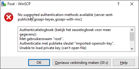

Hello, I'm a developer working to incorporate the support of WinSCP with our product, and we've just received a bug report from a user which we've been able to replicate.
Essentially, when WinSCP's language is set to dutch, it returns an error when we're trying launch it through our software (this does not present itself when WinSCP's language is set to English).
We're sending the parameters configured in the required way described, but is it possible that the parameter names are changed with the language of the software?
I have attached a screenshot of the error.
Description: This prompts when we're entering the passphrase for our private key. Again, when the language of WinSCP is set to english, this is not an issue.

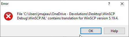

I downloaded the Debug WinSCIP, it did not have any other language besides English.
So I followed the steps (Starting with the *Get More* button) and downloaded the Dutch language, proceeded to extract it at the same location as the .exe,
and then I could see the Dutch selection. However when I attempted to select it, it gave me an error message, and restarting WinSCP does not fix this.
(To be clear, the language is not changing, so I can’t test my problem).
Description: This is the error I get when I attempt to change the language to dutch.
