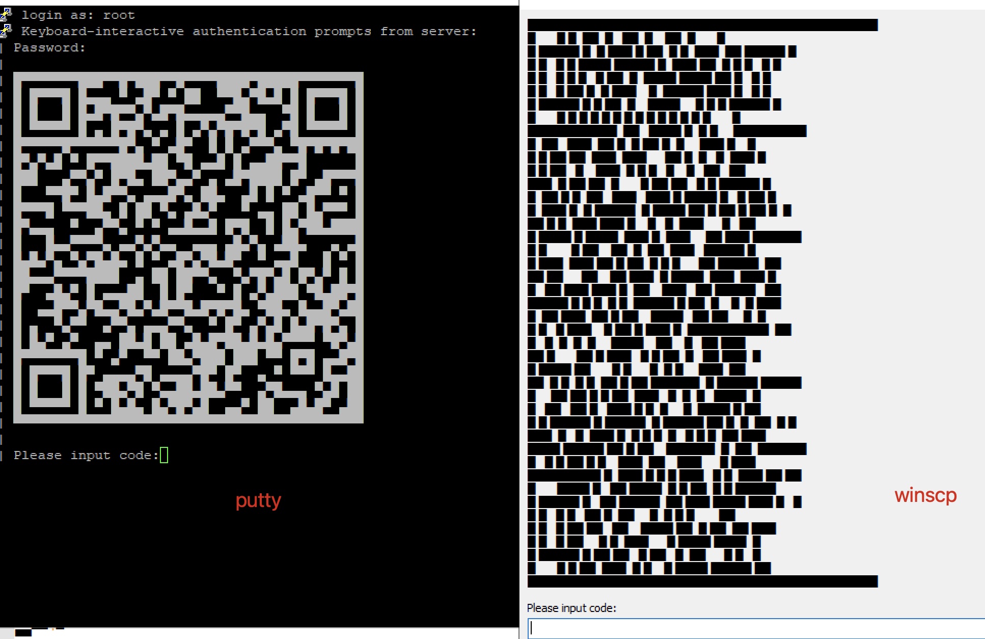

UTF-8 support in 2FA dialog
Re: UTF-8 support in 2FA dialog
It's rather due to the proportional font used in WinSCP.
You can right click the prompt to copy it to the clipboard and paste it e.g. to Windows Notepad.
sunminlei@...
Yes, you are right. After copying the QR code information to vscode, it can be displayed correctly. Then, is there any official plan to use appropriate fonts to fix this problem?
