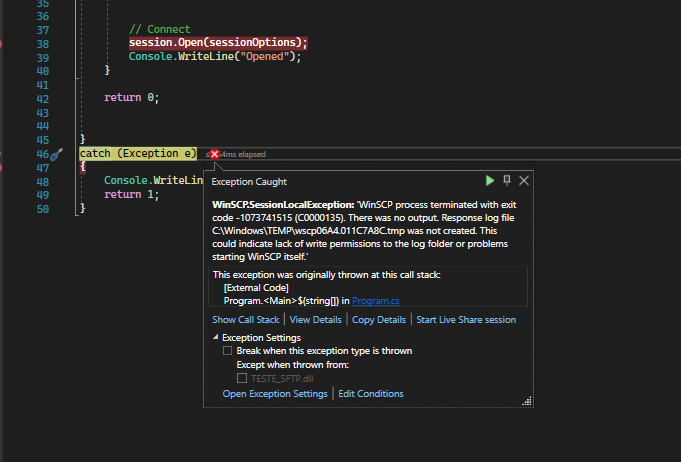

niltonwjr
Brazil
Martin, could you share a example of this project running .NET Core + WinSCP NuGet on Windows container with this simple code?
I'm having the same issue reported by @abraham when I try run a Windows container using Docker Desktop. If you need a example I can post a GitHub repo to reproduce the error. I tried using .NET Core 3.1, 5.0 and 6.0 and in all of those I get the same error.
Description: EXCEPTION.
@niltonwjr: I do not think there's any code to show. I've actually posted a link to a code I've used in my previous post. But again, the code is hardly relevant. The error is unrelated to the code. It's rather about the environment. Can you post complete sample project including your Docker container setup?
Thanks. Though, can you guide me further? I've very little experience with Docker. How do I run your project? What command do I use? Or should I be able to use it from Visual Studio?
niltonwjr
Brazil
Martin, I'm using Visual Studio to run and debug the app, the LaunchSettings has a profile to run it using Docker, just select it and run in a container.
As @abraham.dominic mentioned, your Docker Desktop need to be set to run Windows containers.
ps: If your Docker Desktop is configured to run Linux containers it will ask to you if you want to change to Windows container when your start the app.

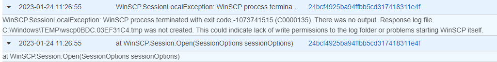

mfuscolin
WinSCP process terminated with exit code -1073741515 (C0000135) ECS Farget Windows Container
I have the same problem in windows container ECS Fargate. I using .NET Core 3.1.
