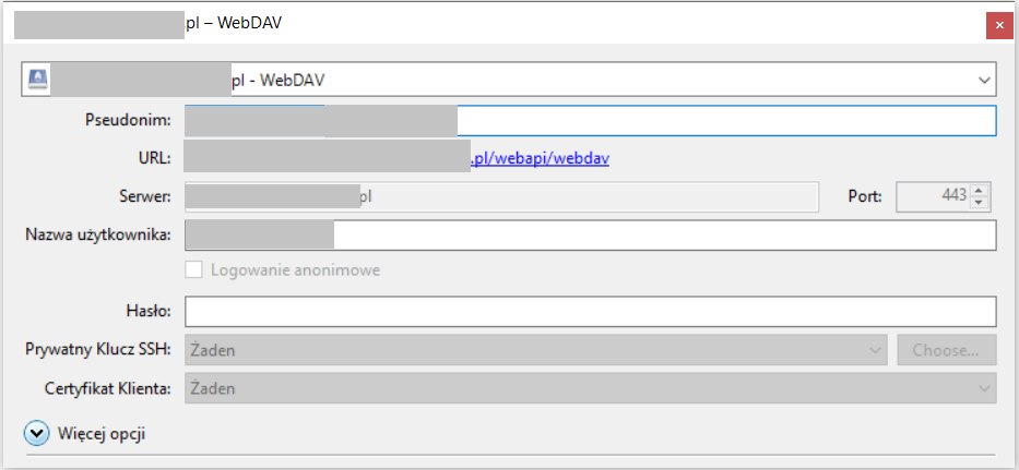

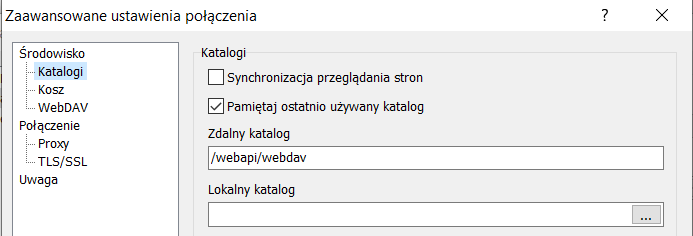

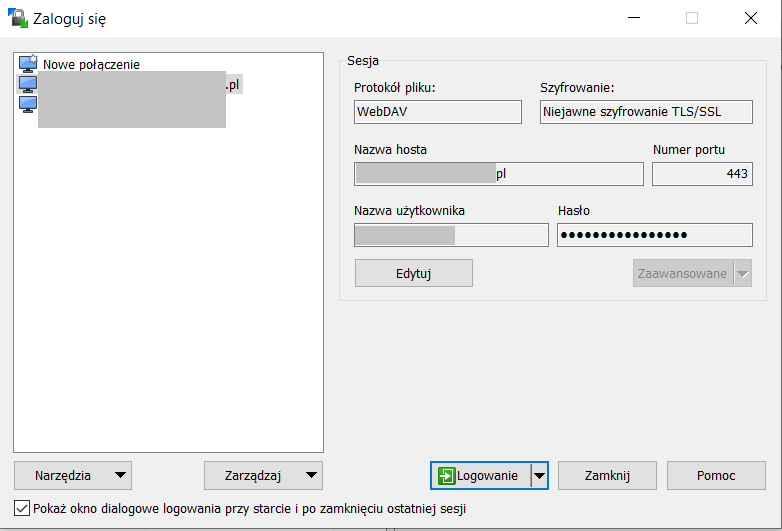

I'm trying to connect to the remote server using WebDAV protocol. I put correct hostname, user and password but WinSCP ask for password again and again. If I put wrong password I get exception in the log and WinSCP shows password prompt again. How this can be fixed? Is this an issue on my side?
I'd like to mention that the following issue doesn't happen in Cyberduck.

Hi Martin!
Here I paste screenshots from WinSCP and Cyberduck. In my opinion the configuration in WinSCP is the same as in Cyberduck.
I replaced hostname in the logs I pasted before not to reveal the real hostname. Of course I didn't change the syntax and path in logs.
