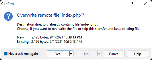

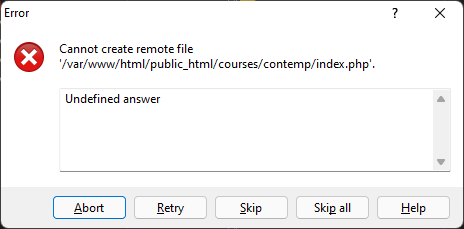

When I tried to overwrite a file on a remote machine, if I clicked "Yes" button, the file overwrite was always successful. However, when I checked "Never ask me again" and pressed "Yes" button, I always got the error "Cannot create remove file" with "Undefined answer".

I have sent you an email with a development version of WinSCP to the address you have used to register on this forum.
