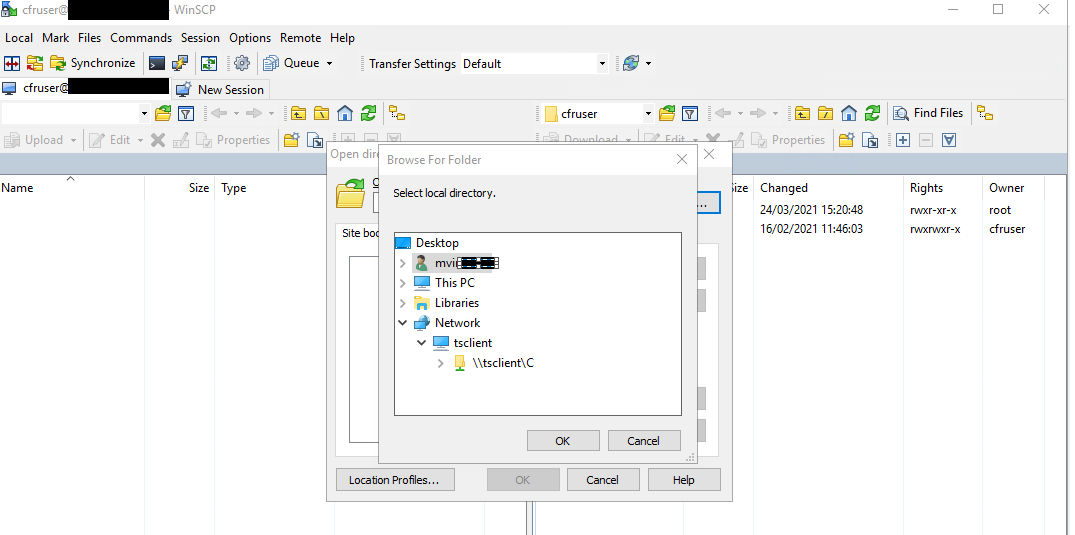

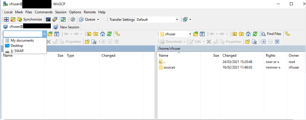

In the following screens, you can see :
1. That the drives are not displayed in the drop-down list
2. That the drives are well mapped through the Windows File Explorer of WinSCP
But as I said previously, the drives are not displayed in the drop down list and we cannot add the drives once the process is launch because UNC Path are not supported.

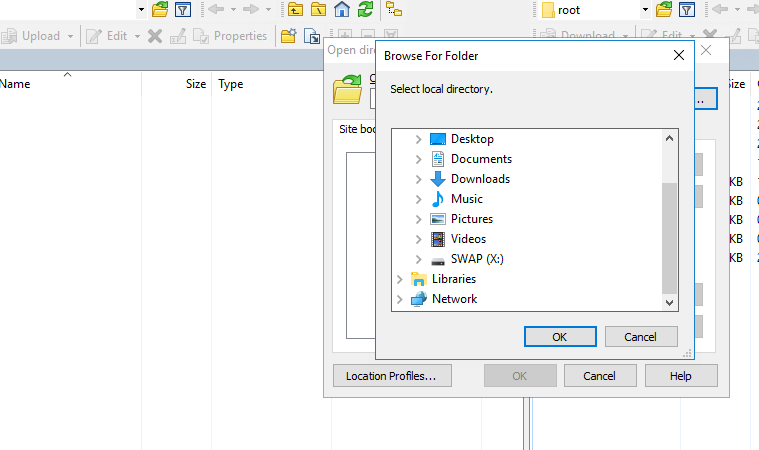

Your screenshot does not show any mapped drive. Mapped drives are under the "This PC", which is collapsed on your screenshot.
mviruser
4

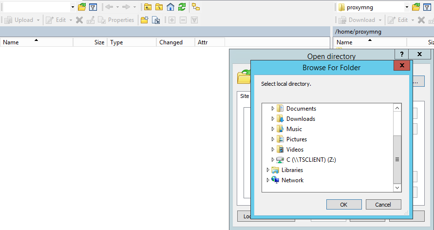

Hi Martin,
That's a good point. When, it works, I'm able to see the drives mapped (cf functional_test). But, when it doesn't work, I'm stuck with the "X:\SWAP" and this behaviour is identical on my 4 servers. (cf nonfuctional_test)

What do you mean by mapping is correct? Can you see the mapped drive anywhere else, when you do not see it in WinSCP? In Windows File Explorer? In another other application? So far this does not seem to be WinSCP issue.
mviruser
4
Hello Martin,
This may be a language/technical abuse, but since I see the disk in the "Network" tab and can browse and see my personal folders there, it means that the disk mapping is functional and that the intermediate server sees the disk.
Technically, if the mapping with CyberArk hadn't worked, I wouldn't be able to see this "\\tsclient\C" disc in the "Network" tab and would see absolutely nothing. (cf "HOME2.PNG" in the discussion above).
So are you saying that the mapping doesn't work because it is not displayed in "This PC" ?
Thank you for your help and clarification, unfortunately I am not a system expert ...
